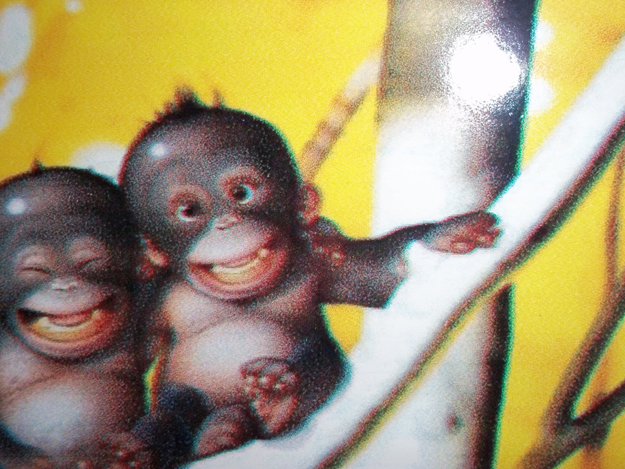

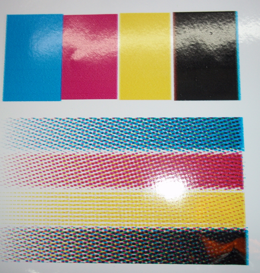

Well I got it to print the yellow and black but now I have a new problem. my test prints look out of register. I adjusted the heads which look like no one ever touched them before me. They are all aligned right now, thought that would fix the problem but I still get crappy prints. I have no idea how to fix it this has never happened before and I can not find anything about it in the manuals unless I keep over looking it.
