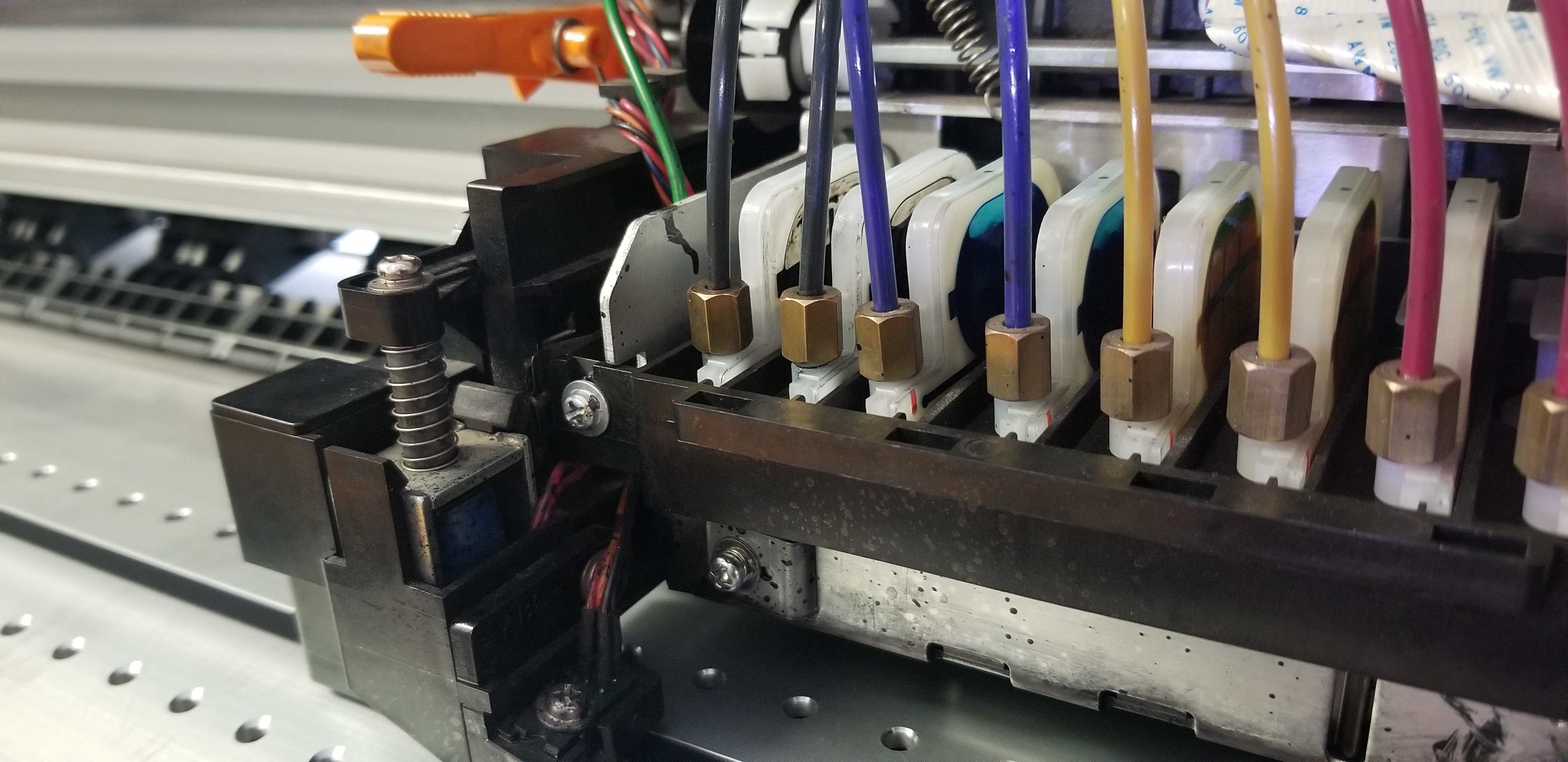

It seem I was able to get the black to free up and now I can pull ink thru the installed dampers. To be sure I was making the right steps I also decided to change the blue dampers as well. When I stopped last night I was still not getting proper output from the cyan and the black. However the dampers (I changed) aren't completely full.
By running ink can I fill the damper from this point?
Or am I priming the dampers incorrectly
I'm trying to run solid cyan right now and I'm getting a yellow output? The cyan line looks blue...
Also The black I run has a magenta output.

Dampers are not suppose to be completely full. About half full is correct for dampers. Running a "Little Charge" should properly send ink all the way from ink carts to the print head. Sounds like you have some cross-contamination. Printing a large block of black and a large block of cyan should clear that up.
RG I sincerely appreciate you devotion to my issue. The little charge did the trick, I cannot thank you enough. The cross contamination is gone and my test prints look PERFECT again!
