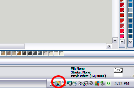

The most common way to print and/or cut a job is to first open it in Omega Composer. Once open, you can either Output All (Shift + F11) or Output Selected (Shift + F12). This will launch the separate program named GspPlot where you will find all the tools you need for sizing, repeats, etc. as well as buttons for printing to the Edge or cutting to any installed plotter. You can also open any saved job directly in GspPlot. Once the job is sent from GspPlot, it will appear in GQMgr, which is a print/cut spooler that automatically sends the data to the installed device.
Installing of devices is best done through the GSP Tray > Install Vinyl Printer or GSP Tray > Install Plotter / Router. The GSP Tray should be appearing in the group of icons that appear on the right side of your Windows Task Bar. Accessing its various menu choices is done by right clicking on the GSP Tray icon.

I installed the printer via the gstray icon. I also tried to output selected and output all and it would not let me go further because i did not have a plotter installed. Same thing with GSPPLOT i tried opening it from the software group. It show up in the program list on start menu but nothing opened up. It almost seemed like it opened in the background but i could not see it anywhere.
Like i said i'm pretty sure the printer is installed right i ran three dif test prints from the GQMgr on both parallel connection and via usb to parallel.
