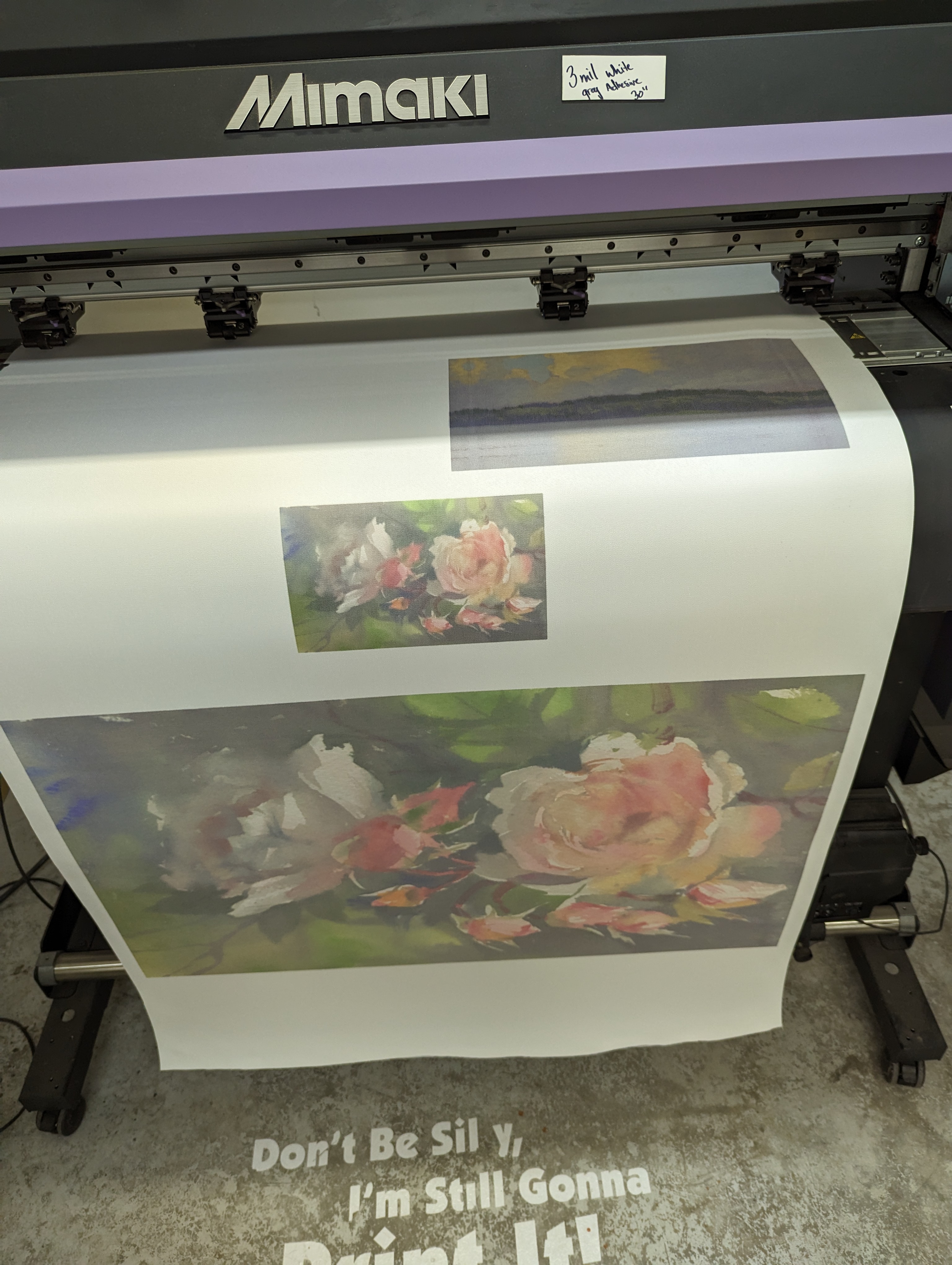

Chris here,
We are running a mimaki cjv 150-75 , and I'm trying to broaden our services and do some canvas printing.
Our images seem to be coming out a bit light, I have been trying to use a canvas profile in rasterlink 6, but the images don't seem to be as saturated as I would like. Also using a cheaper (I think) roll of canvas, I'm not sure of the brand.
Any suggestions?

I would bet that canvas is not properly coated for solvent inkjet use.
Hey Greg! Do you think this could be my issue? I got a cheap roll off Amazon (that was probably not the right solution) , it was advertised for digital printing but I haven't had alot of luck so far...
There are three types of canvas that can potentially be printed on a digital printer:
1) Aqueous coated canvas
2) Solvent coated canvas
3) Uncoated (raw) canvas
Of these, only the solvent coated medias will yield acceptable results with solvent ink.
Some UV, and Latex inks can successfully print to all three types of canvas.
Designsquid
I am definately going to try this out from a local supplier, hopefully I can get a better quality print from it! Thank you

HI
we had the same problem
in the rip go to colour management and set it to max density US
good luck
you may also need to slow the print speed down to give the ink a chance to dry
