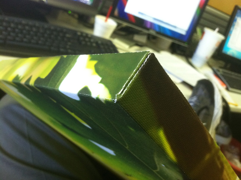

Hello, I've searched and can find nothing on the site about this. Does anyone know of a canvas material that doesn't "crack" when you stretch it? Meaning... on the edges of the stretched print (see attached picture). The one that I have tried (sihl) seems to crack really bad on what appears to be the coating on the media. I'm printing with a Roland SJ540. The attached picture isn't the best example, but you'll get the idea. Thank you very much for any leads! Miked.

All canvas (painted or printed) will crack to a degree on such a harsh edge. slightly rounder edges will help, so will preparing the surface of the canvas with a surface treatment (any sort of archival quality clear coat will do) and it will help provide some surface tension to prevent cracking. ... that looks like an aqueous print ... so here is the deal on that ... they coat aqueous canvas with a surface to be inkjet receptive ... you'll need to get a spray on varnish that when the surface is flat will help that stretching ... will still crack, but the varnish will hold it together to hide it, follow up with a finish coat of varnish and your done. You can do the same thing with a high quality can of clear spray paint if it's not an art print ... doesn't need to be thick either. .. and if it's aqueous will seal in the painting a little more so dust won't ruin the print.
Edit, looked it up ... eco solvent right? still clear coat ... will still do wonders. ... just go for a varnish ... something ment for acrylics will do better as the acetone in most other spray on clear coats will eat the ink.

thanks everyone! I'll give the "experimenting" with different coatings first since I have almost a full roll. If that doesn't work, I'll check into that media that you guys mentioned.
