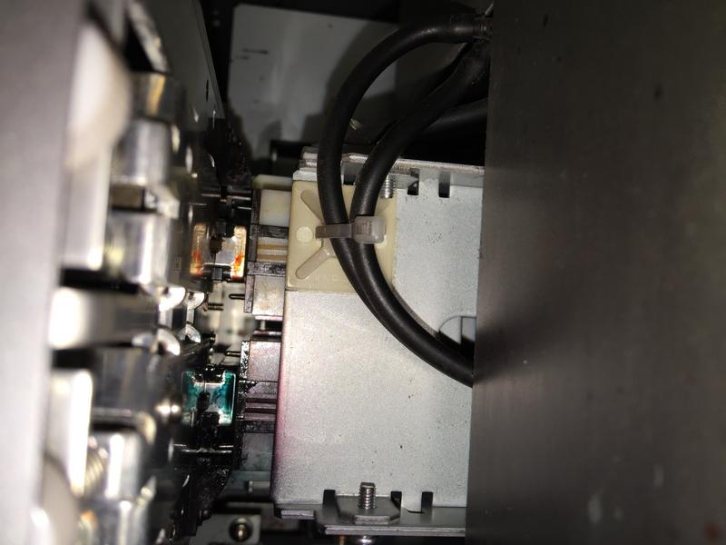

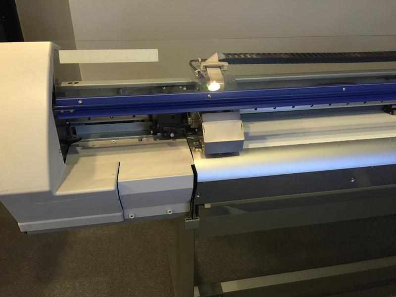

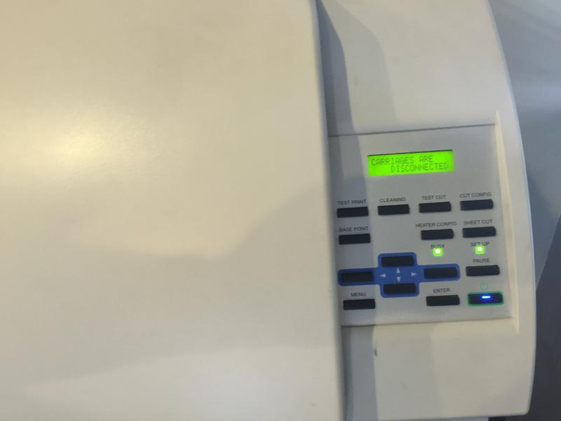

Can someone please give me a suggestion on where to look to reconnect the carriages on my SP-540V. My decals were printing and cutting poorly so I cleaned the encoder strip which I have done in the past to fix this problem, but now I have a new problem...error message "carriages are disconnected". Thanks in advance for your assistance.

Slide it back and connect it before you have a bigger problem with dried up heads??
I turned the machine off and then back on to get the head to go back to the start position (so no dried up heads), but how do I reconnect the carriages? When I run my print job it moves to the same position on the far left side and then stops and gives me the error message "carriages are disconnected"
Signs4Realtors
Clean the strip again, or flip the strip or replace the strip.

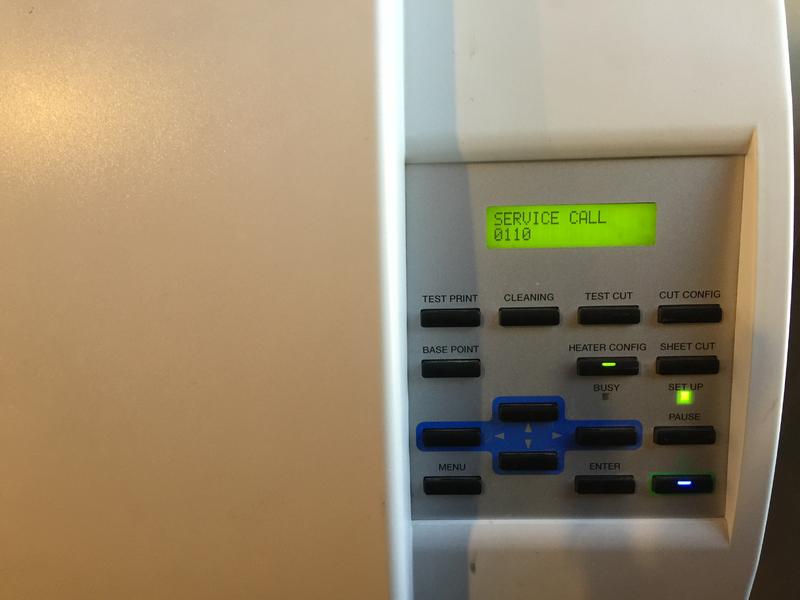

And now I am getting an error code "service call 0110".
I guess that means I need a Roland technician unless someone has another idea?

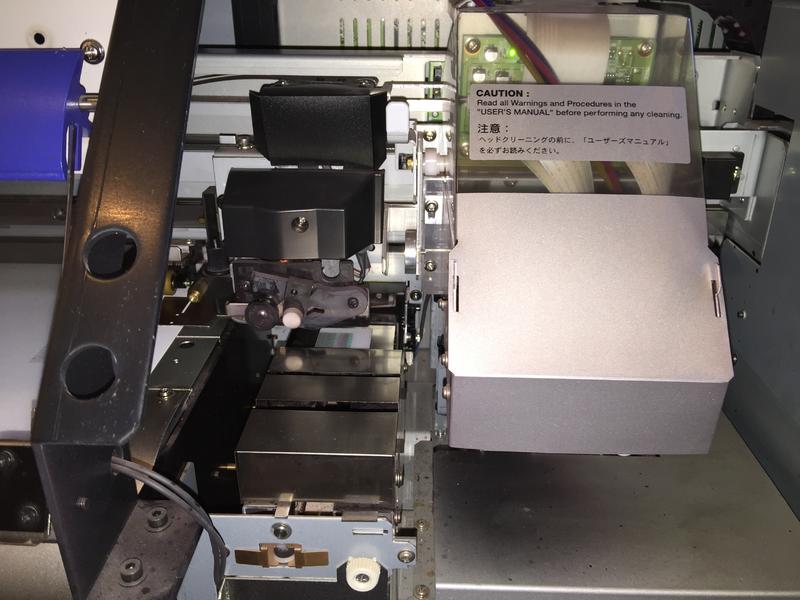

When I turn the machine on the head goes to the left fine until it gets to the far left roller position and then it returns back and gives me the error message...not sure if the far left roller position is always where the machine returns from or if that's where maybe the encoder strip is messed up?

Has you head redocked and capped yet? Does it redock and do the caps seal the heads?
If not, there may be an easy solution.
If appears that the head has redocked and capped...see last closeup picture and let me know.
I left a voicemail for a Roland technician to schedule an appointment for him/her to come out and tune up the printer and fix the problem, but I'm getting behind on print jobs in the mean time...would love to find a quick fix for this problem.

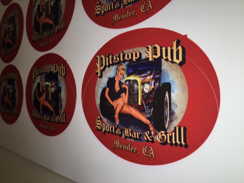

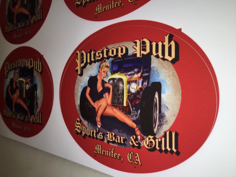

In one of the pictures you can see that the ink on the sponge is not in the center and is off to the side and was partially on the metal as a result of the wobbly printing that my machine was doing prior to cleaning the encoding strip. Attached are what the decals looked like after print/cutting one row of decals at a time (4"x6" decals 11 across one row). One print job would print/cut correctly and the next identical job would be off significantly.

If environmental match didn't execute properly, the first thing I would do is run the service menu encoder calibrations. If they fail, your encoder strip might be damaged and not just dirty and your encoder sensor might be bad. If you replace the encoder strip and sensor and still get the same error, the last part that could be failing is the servo board.
The only problem is that the environmental match failing may be a secondary problem. The original error you are receiving could just be the sensor that detects if the carriages are connected is failing. I have also seen the tool carriage cable go bad and cause the same issue. Have you been having trouble getting the machine to measure the material lately? Does it measure 0.0" sometimes or just throw up a pinch roller error randomly? If that has happened to you in the recent past even once, it means your tool carriage cable is going bad and could be the reason you are receiving the carriage connection error.

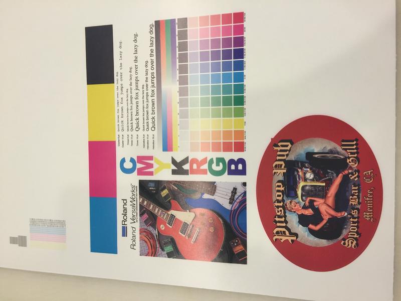

Not sure how to run the service menu encoder calibrations? I ran the menu calibrations print selection, and then ran the test print and cleaning (and deep cleaning menu option) and that enabled me to print the attached test print along with a perfect decal with perfect cut line...but the menu environmental match still comes back with the error code 0110??? Maybe I can just keep printing until the Roland technician shows up. The print looks great and there are no error messages unless I run the environmental match which I have never run in the past???
