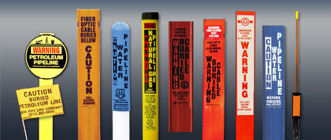

Does anyone know what media and laminate are used in decals for Carsonite marking posts? All the websites I've been able to find just say tough, vandal resistant, non-chipping, UV Protective material. Someone is asking us to make a few decals for a hiking trail.
Is it just a normal permanent adhesive print media with a tough lam, or maybe a polyester media?

We have done some of these for a local bike club. They bought the Carsonite and we printed on ij180 and ij680. Laminated with 8518. No problems.
