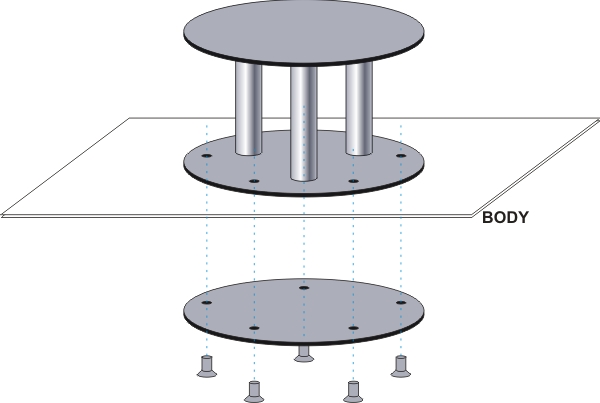

Jester1167
I would add and armature so it doesn't pop off and a plate that attaches under the body. I would also fiberglass the outside.
You might suggest they spring for 2 or more at a slightly reduced price. May even make sense to build a mold off the original so future ones are easier to make.

I don't think their budget will go for fiberglass, and I don't know much about it but will look into it. We've already talked a bit about making at least one spare in case they roll it. I've never made a mold, so would have to do some studying about that. I've been teasing my son, (the potential driver) that I will pose him and coat him in crisco and use him for the mold. He's probably worried, (having grown up in a custom sign shop), that I may really do it..... If I can find a way to do it that's not toxic, hmmm.
I like the armature, but then couldn't use styrofoam. I wouldn't think the spray kind would be suitable for carving. ?? I have a lot of research to do, thank all for google!

Since I've got 3 year old boys who love monster trucks we watch them before bed a lot. The biggest thing that jumps out with the aluminum armature is that it will get somebody killed. The trucks are just a cage with a fiberglass body draped over them. When the truck crashes/rolls over that aluminum framework is going to go somewhere and there's nothing to stop it from stabbing the driver.

mount some type of loop to his belly and tie-down strap him down running the straps through the windows. Easy on/off, can attach a soft "body" and no rigid mounting brackets to impale the driver.
