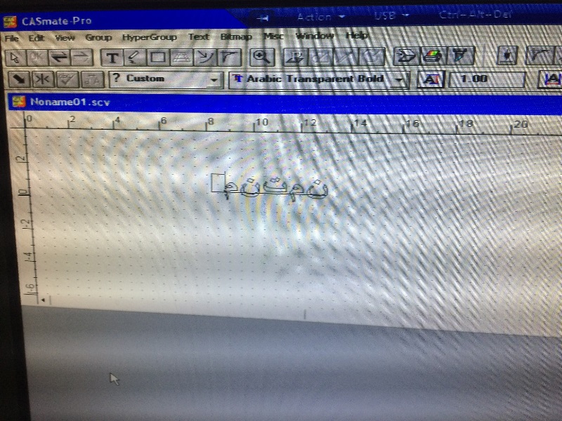

well i download one picture for better understand my problem
in 1st pic u will see it that the right Side is arabic written which is correct and in then 2nd pic down right side u will see the letters are not connecting
any suggestion?

That appears, to me, to be a kerning issue. This is adjustable in pretty much any layout program- I just don't remember where it was in CasMate's text layout tool.

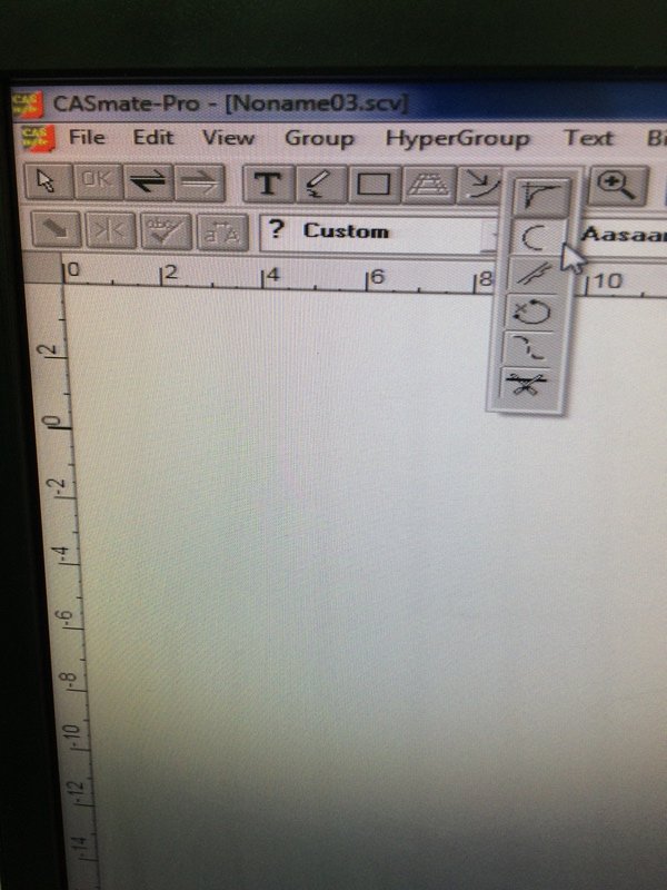

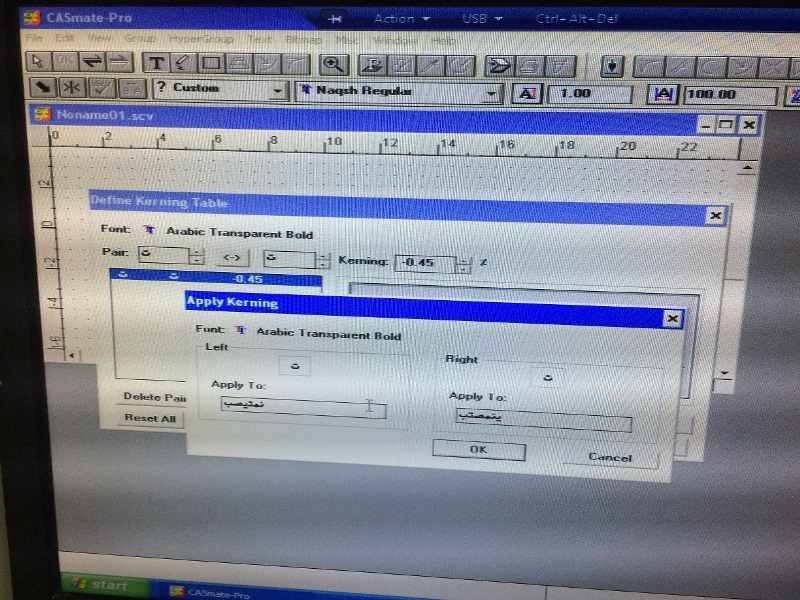

i found the Kerning option. as i am not familiar with this SOftware and dont know how to use it
but i found one more thing which is weird
when i am adding the kerning option and typing Arabic its work fine, but dont know how to use the kerning. and when i am typing in normal text in a file. its not working see the images.
