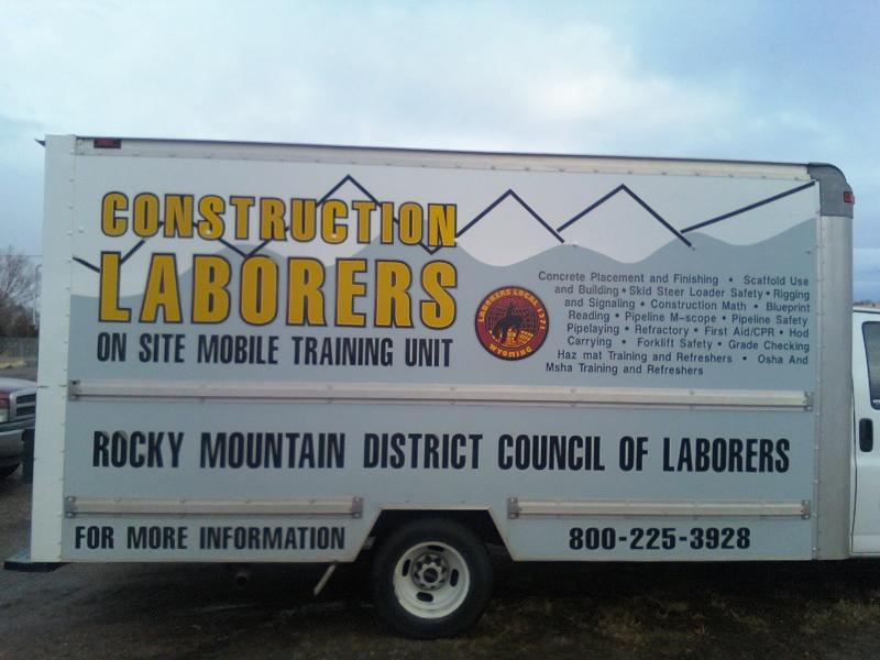

I lettered this truck about two years ago. Some of the lettering was damaged in an ice storm so they want to have everything that is not in great shape replaced. All of the original lettering is Avery intermediate opaque vinyl and all of the Black has shrunk, leaving adhesive residue around the letters that has attracted dirt. The Black behind the yellow letters has also split in some places. I have since switched to Oracal 651.
I have at least two questions.
If I replace this with cast vinyl will it prevent these problems?
They have asked about putting a clear coat over all of this. I think they will spray an automotive clear coat over it.
What problems will that create?
Sorry about this being so long but, trying to cover all the questions with one post and I thought the background info would help.
THANKS

Cast is king for vehicles. Calendared vinyl is fine for site signs and banners.
Never had a problem with sleet, freezing rain or hail. Icebergs maybe.
Letterbox Mike
Cast will solve this problem, preferably not Avery cast. If in doubt, go 3M.
I don't think I'd be clearcoating over that either, seems like a recipe for disaster, or at least a permanently unsellable trailer. Why do they want to clear it?

I probably wouldn't be scared to do that in Oracal 651. That stuff stands up pretty damn good. Is cast king? Yep... but sometimes that's not what the budget will support. I do very little actual cut vinyl anymore though- I'd probably print that instead (understand that may not be an option). I guess the big question is how long do they expect it to last?
I don't think I'd want to clearcoat it..

Cast vinyl, no clear coat. You can order 3m cast vinyl in short rolls (say 10 feet) ... definitely worth it.

Thanks for all the feedback ! Seems like budget is always a factor and I try to explain to them what they can expect. After seeing what price get them, they have decided to pay for cast this time. Cast, no clear coat. Thanks again
