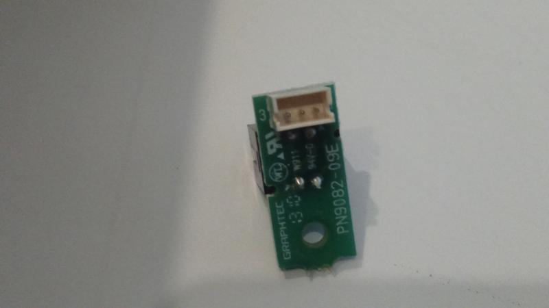

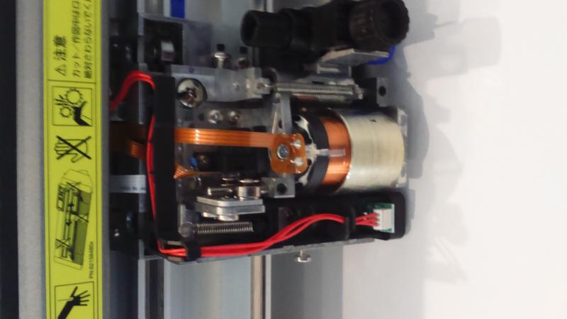

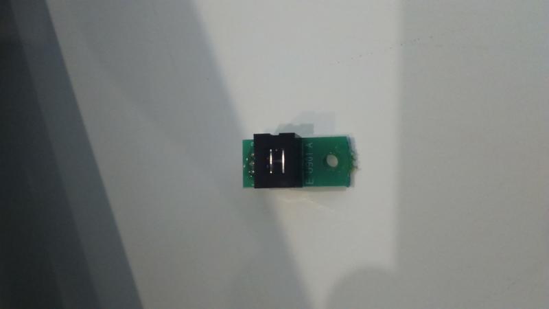

studio10
Hi,
again I had problems with reading the marks. The only thing I have not done is clean the sensor. So I took apart and cleaned sensor carefully with a dry cloth. Now read without problems. I am not serviceman but simply not have another solution, so I had to try it.
