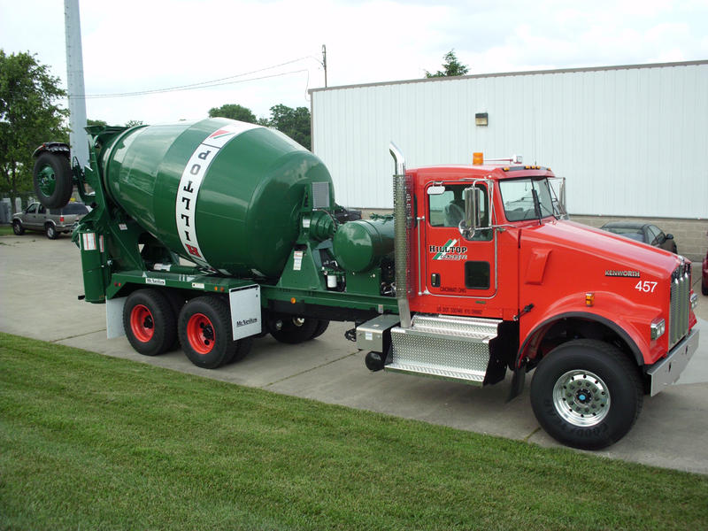

yes, we DO use 3M edge seal (in the can) on the drum.
for install on the drum, you have to turn it on REAL slow and squeegee quick!
