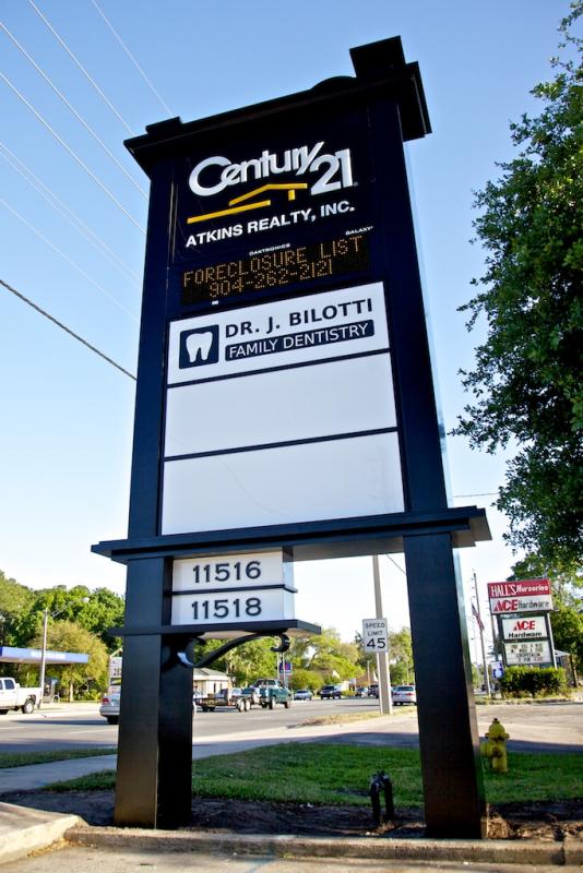

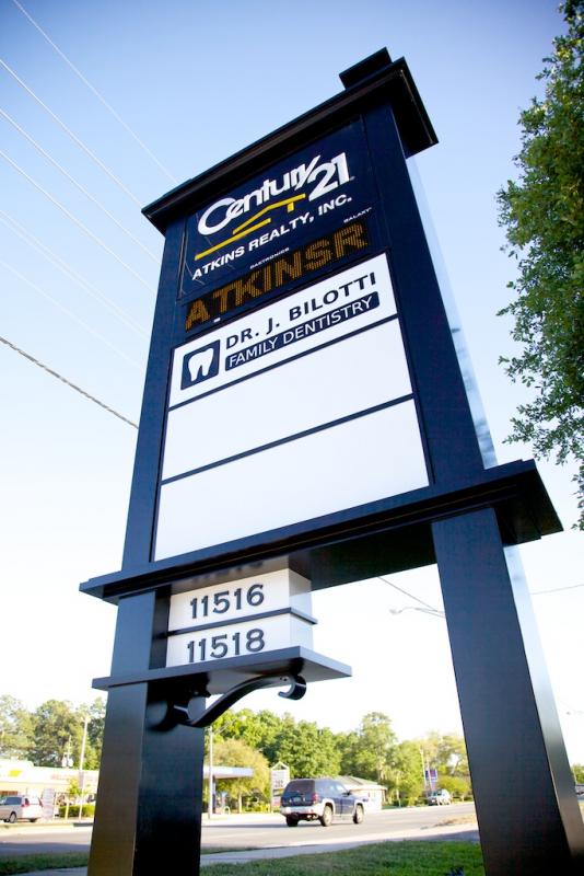

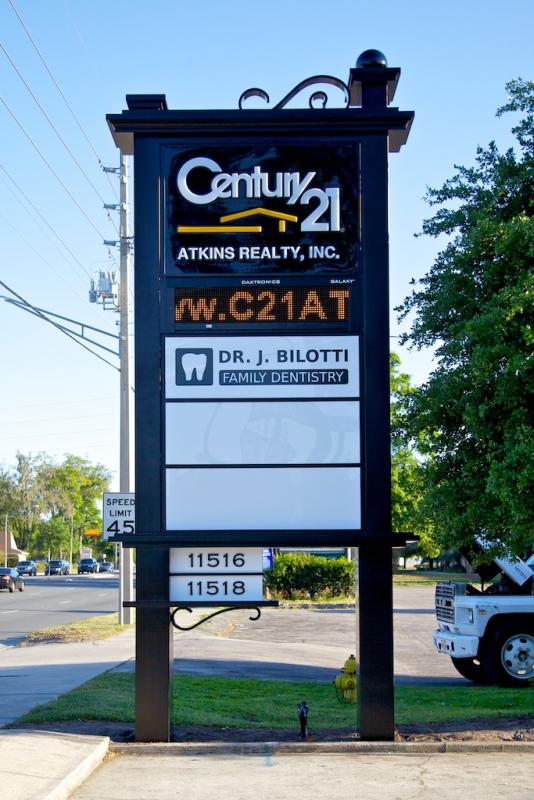

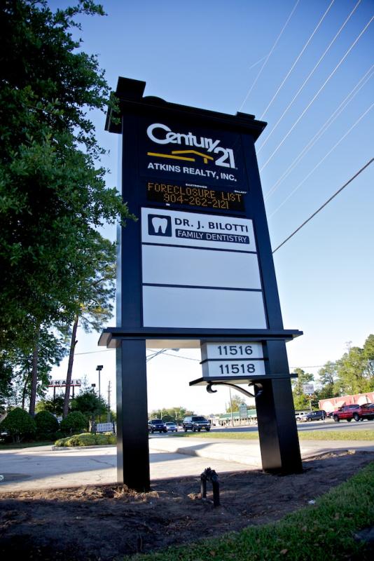

Here's one we installed today...
99% Built in house (The LED message center was ordered from Daktronics)
The sign is all aluminum... except the scroll work and faces. We router cut 1/2" PVC scrolls and "sandwiched" them together to make it 6" deep.
Design was a collaboration between me and the customers son (an architect)

Is that your truck in the background, with the hood open? Troubles???
(Hate when that happens on the job site)
cgsigns_jamie
Yeah... that's the trusty bucket... I don't know why the hood was up, to be honest with you. I know the truck had been sitting for about 6 months before we brought it to that site, but it ran fine there and back.
You're right though... it's always nice to have equipment failure on a job site... makes for a real professional appearance!

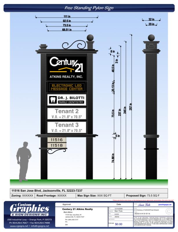

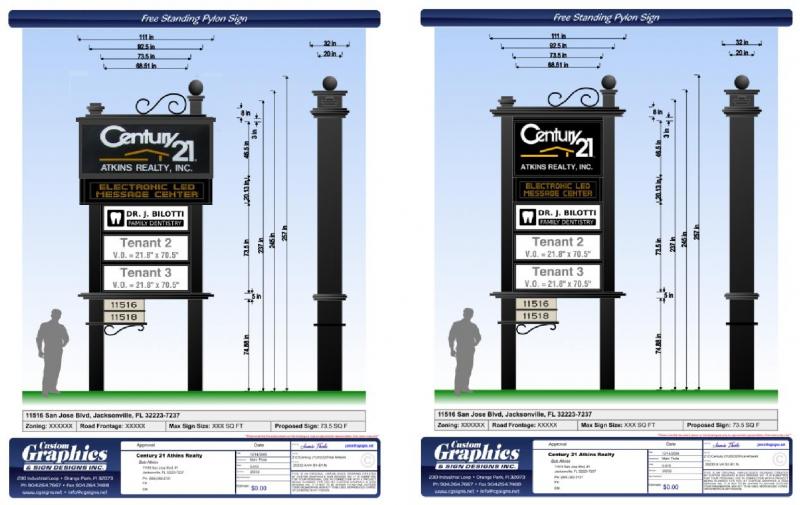

You folks do some nice work. Excellent craftsmanship on the construction of this one, but it needs to be about 2 feet wider. The "century 21" needs some breathing room also.
cgsigns_jamie

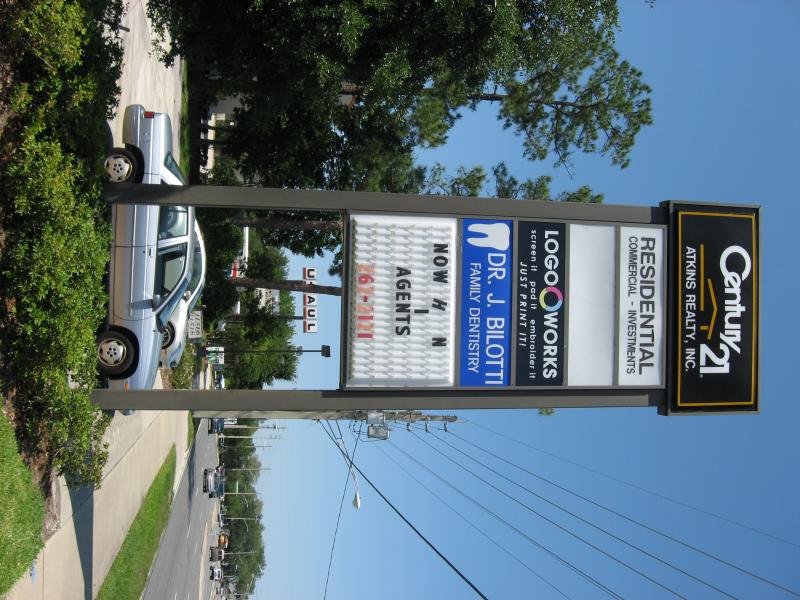

Thanks Skyhigh... the sign was limited in size because we were utilizing existing support columns... here is a photo of the old sign and a copy of the proof.
Also if anyone's interested here are the photos of the sign in the shop during construction. My father used to own a body shop and painted show cars. This sign received the same treatment as a Rolls-Royce..
... Sorry for the rotated image... I have no idea why it did that??

Like I said....excellent craftsmanship in all your work!!!!
I may have done something like this (Its always easier coming up with ideas after....haha). Still an excellent job Jamie!!!
