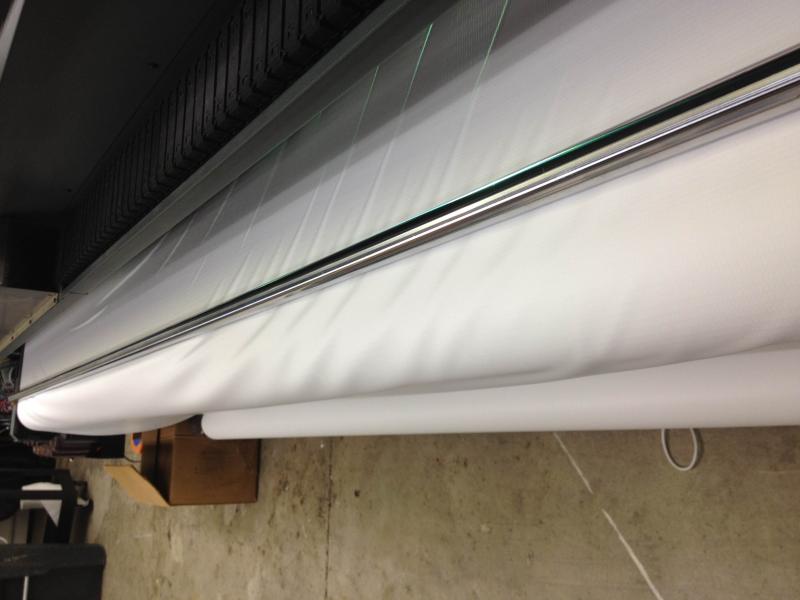

See the attached image, the material sort of buckles or gets wavy as it feeds up and onto the belt, and the farther along it prints the worse it gets and the less they smooth out. Like I said, I can't say 100% this is not user error as I've been too lazy to try to address it with CET, but again I've heard of this happening on many other makes of belt-fed hybrids so my gut says it's the nature of the beast.
Even if it's a fluke on our machine, I'd still consider a true RTR printer if you intend to print a LOT of wide banners, this works in a pinch, but for any volume I wouldn't consider it.

Yeah, it's weird. Part of me doesn't think it's normal, but for the life of me I can't figure out what causes it either. I have to assume it has to do with the tension on the feed reel but I've literally run through several full rolls of material trying to dial it in and I've yet to find a setting or combination of settings that works correctly so who knows... We do very little 8' banners so it hasn't been a huge deal yet, which is why I haven't made it a priority to bring up to CET.
Under 8' it's fine. We do run a lot of 54" wallpaper on it and have never had the problem, so it has something to do with a full-width roll of banner, something is either not feeding straight or at an even tension, or the roll is sagging in the middle as it feeds in. Dunno...
