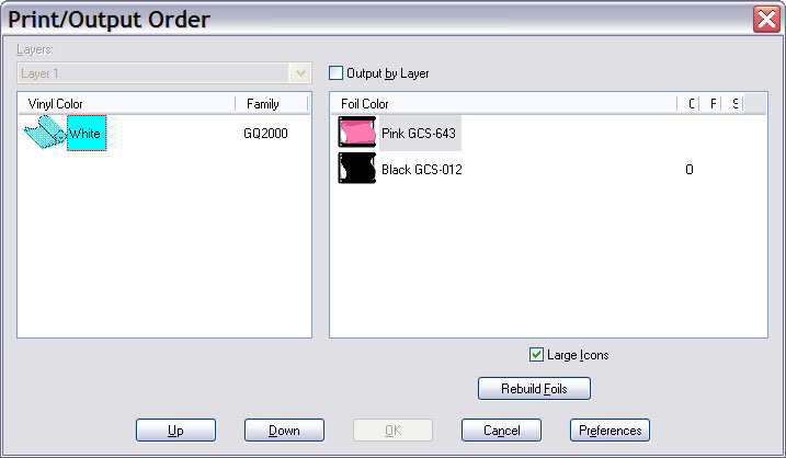

That is correct, but I am talking about the 1234 dialog in Composer ... not the 123 dialog in GSPPlot. It provides for changing the print order.

Cool! I never used that before. But I'm still concerned that this won't solve the problem because the yellow is still assigned the overprint for the choke/spread. Aren't I still going to run into the same problem as I would by changing the print order in 123Plot? Sorry if I'm just not getting it!

I know I'm not like everyone else, but I always print lightest colors first. So your design is different from what I can advise on best. But if your yellow is set to overprint then it should be below the blue in the 1234 and the choke/spread should then pick it up as the top color in that operation. If you need blue to be the top color, then that should agree with your print order ... which is shown, of course, in the reverse of choke/spread because it's print order from first to last.
If I were setting up the job, I would have the text and circle in blue and combined and set to overprint on top of an inset yellow circle. I would then run a choke and spread and blue would be the top, overprinting color as well as the last color to print in the 1234 dialog.
