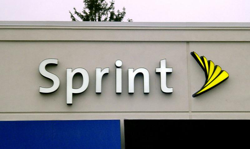

A new Sprint store opened up in our town this month. It has a wall mounted sign of white channel letters with a black return. I got a call from an out of town Sprint representative today asking if we could make those letters black but so that they would still light up at night.
I'm pretty sure I've seen this done before using a perforated material. Letters are black in the daytime while the light shines through at night. That job was high in the air, about 30 feet, so the perf was not noticeable in the daytime. The viewing distance of this sign however is much closer 12 feet. I'm not sure what it will look like that close using perf. Maybe white polka dotted?
At any rate, has anyone ever done this or know the type of material I need to meet this challenge?
The job is simple enough if I can find the right stuff.

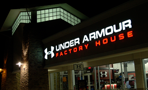

i'm not at the office to access the day-shots, but these underarmor channel letters are white led with white acrylic faces, laminated with black perforated vinyl:
visual800
I have used that Day/Nite stuff and I dont like it. the daytime its black but at night its a muddy greyish looking ...I cant even describe BUT I am liking that perforated vinyl on the faces. KUDOS great idea!
