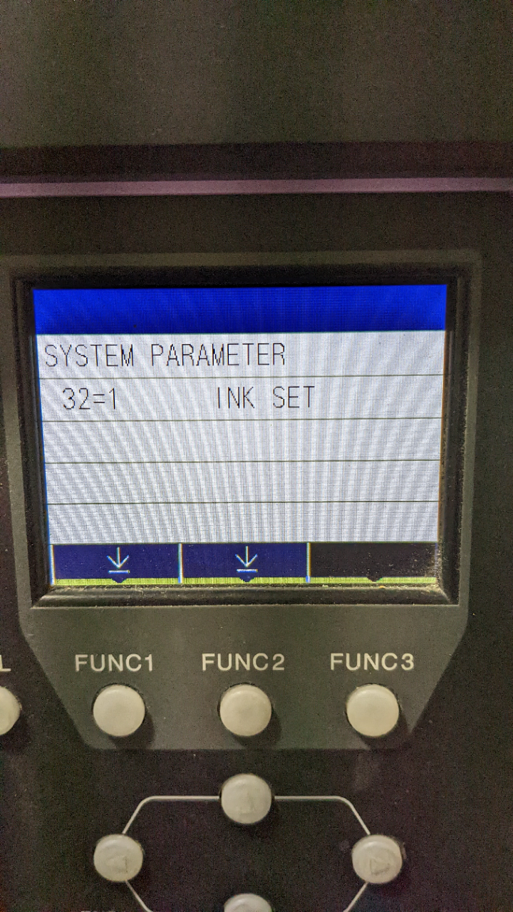

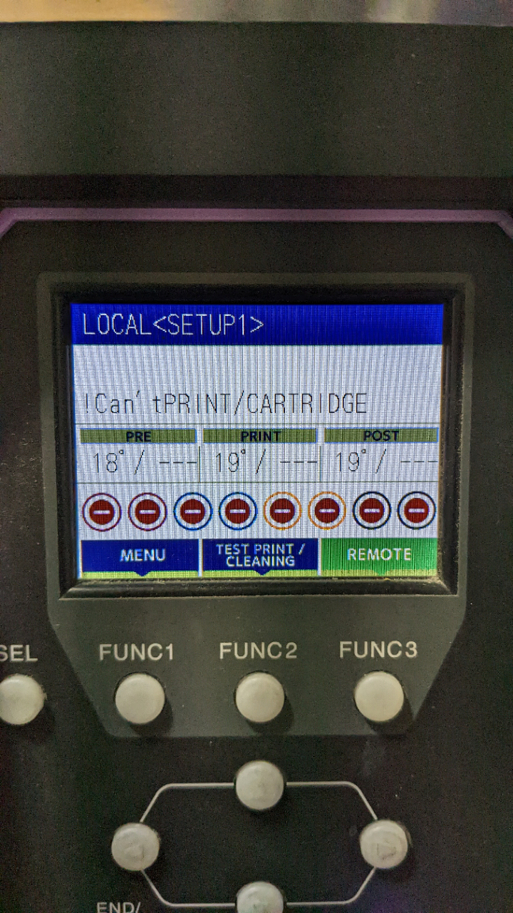

I have installed all es3 carts from the jv33 with the continuous chips andI 've changed the parameter (32?? Can't remember off the top of my head) "Inkset" to '0' for the es3 dual channel config but it still comes up with the can't print error and all the carts are unrecognisable. Wrong ink it says.

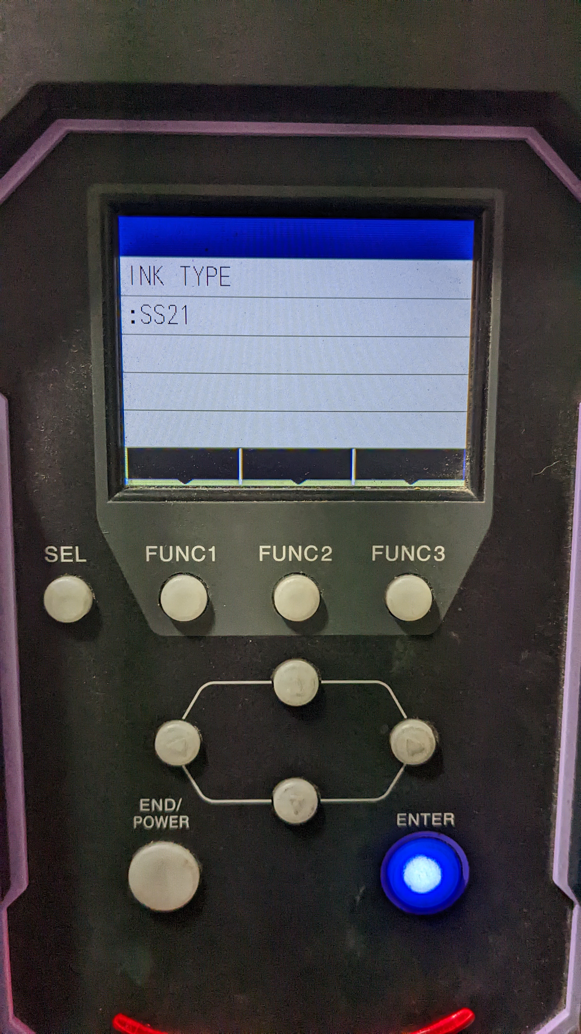

When you boot up in local mode, hit enter a few times and it will scroll through some information on the screen. One of those screens will have information about the ink levels and it should show the ink type it's expecting in the top left corner. What does that screen say for you?
Forty One
Make signs they said... It'll be fun they said...

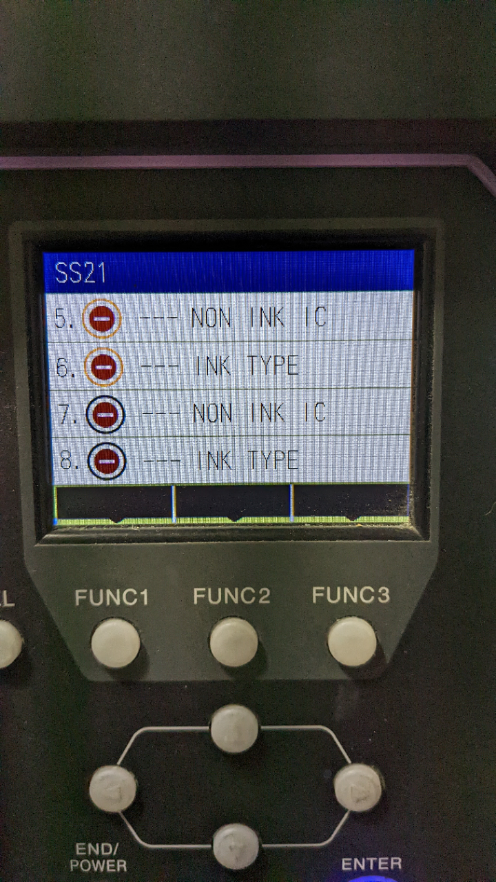

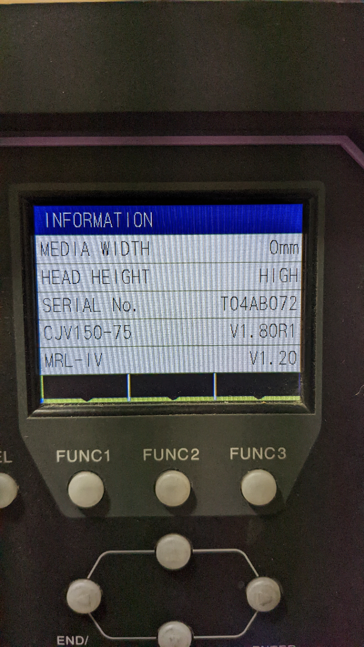

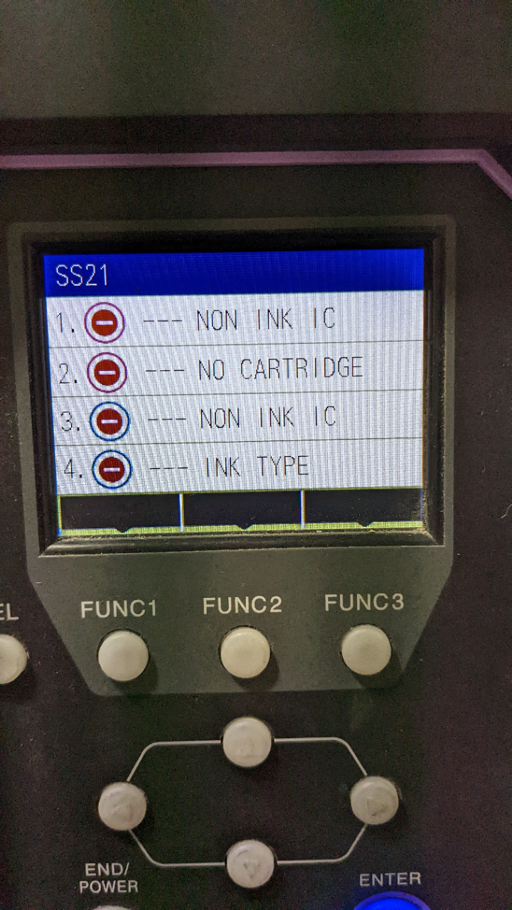

Yeah, it still reads SS21.
Attached are the images.

It might be a firmware thing. Different regions of the world get different firmware sometimes based on which inks are legal etc. Sometimes these machines save the ink type so when you try to fudge the fill up parameter it only gives you the original ink you chose as an option. At this point if it was me I would request the original parameter file from Mimaki and upload that to the printer. It will revert it back to the factory status. When you boot the machine it will start like it just came out of the factory. If ES3 is an option, it will show there.
