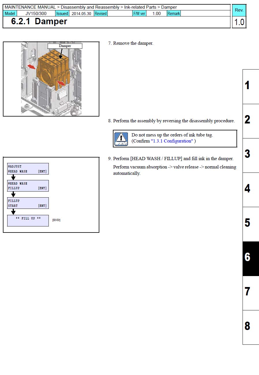

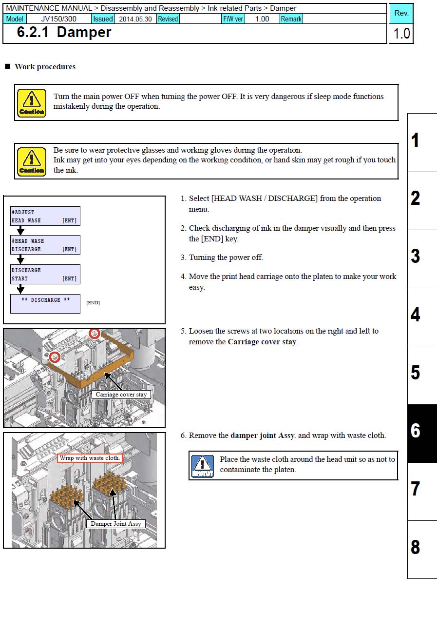

This is what the service manual says for a JV150 (same head and dampers).... It does not mention those plugs so I'd assume if the new dampers do not have them then I'd transfer the old ones to the same spots. Hope you are using genuine OEM dampers.... on our prior machine always had problems with cheap aftermarket ones and have read plenty of stores of problems with aftermarket cheap ones on these newer ones as well.
