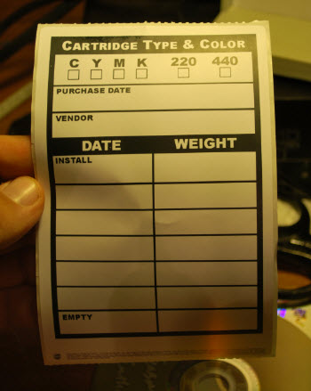

I use a digital kitchen scale to weigh my cartridges.
I weighed a completely empty one (169g)
A completely full one weights 365g... Pretty close to 1g per ml. I use 220's mostly
I put a label on each new cartridge and document the purchase date, the install date, the starting weight, and then I weigh them whenever I am curious where I stand.

Thanks alot J and Bob! I thought there might have been a properties menu for the printer so you know how much ink you have left. Epson desktops has this and I'm sure every desktop printer has it also. I just thought the same would apply to the Mutoh. Guess what, I was wrong! You think it would have been installed in the production manager wthout saying? Oh well, gotta get me a scale! I appreciate the help guys...by the way J where do I get a hold of those labels, I'd like to use them. I'm totally anal with everything I do! Thanx

It is a label I made in Corel. I print them out whenever I need one using my shipping printer (Zebra ZP450)

Anyway, I love the label idea!

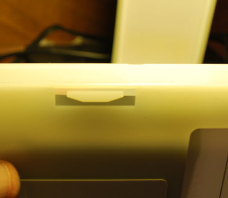

There is a tab that closes a switch when he cart is empty, simply replace the cart when empty... It can be done in the middle of a job if needed... Nothing complicated here, just change it when the machine says to...
