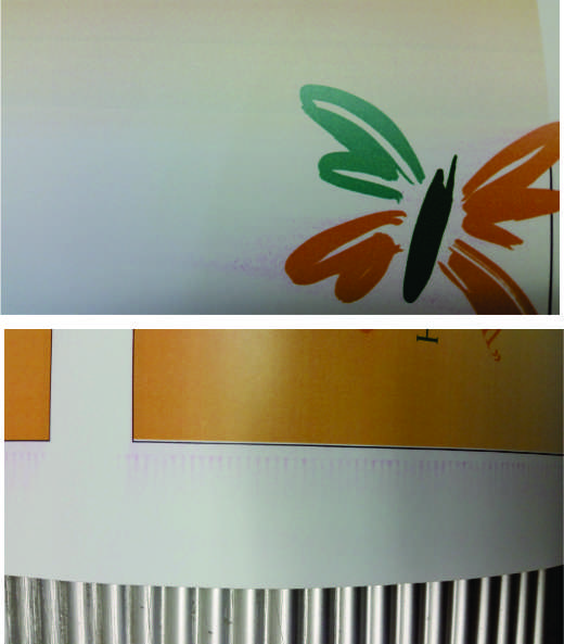

I am having a couple of issue with my mutoh vj1604 and was hoping to get some insight. The first issue is I am getting ink backing up(channel contamination into the lines) equivalent to what would happen if you did a head soak for along time. It typically happends when the printer sets over night. I then run a little bit of print to "flush" out the dirty ink and all is fine. I believe the pump is sucking out the ink through the capping station, because I can see it dripping into the waste bottle on a cleaning. That's question 1..
Question 2: Which could or could not be related. It looks as though I am getting a red overspray on certain areas of print. I have attached a couple of pictures of what it looks like. The picture with the butterfly has the red overspray just to the left of the bottom left wing. (it's kind of hard to see)

So I thought the problem had went away, but it's back now. It seems to always be on the left side of color being printed. I will try cleaning out the drain lines and check the outcome. What's interesting is if I run the printer with a banner profile (4 passes as opposed to 8) then there is no problem at all. Also if I run it in unidirectional mode (printing one direction only), there is no problem. So I don't think it's a static electricity problem, maybe a cleaning will help?? I'm at a loss..

In case anyone was curious.. It ended up being a bad printhead. I replaced and all is good now.. oh and I put new dampers on too..
