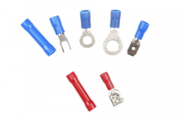

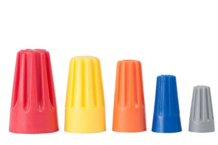

What tools and hardware do you use when wiring channel letters?
How do you connect, say, a dozen of wires? Do you use wire nuts? Do you crimp wires and use terminal blocks?

12 is too much... I've seen people do 10 or 12 on one large wire nut and it looks like a sloppy mess. Split it up and make it manageable... I don't like having more then 6.

If it's 12v use that terminal block with jumpers or a stud. Terminal blocks really just make diagnosing problems easier. You cant load up 12 wires on a wire nut, even 12v will get hot and start a fire. I'm not real crazy about wire nuts with stranded either but this is out of my AOR. Those stab in connectors banner posted work well if youre doing production work
