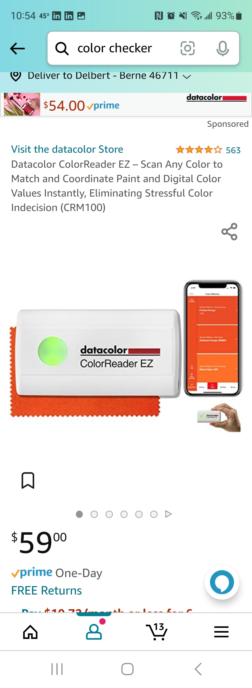

Anyone use any device to color match? Seen this one attached. Any input?

Get a spectro and you will be able to very easily match colors in Onyx for example. It's way better because it takes into account your print profile and gives you very good results.
However you didn't really specify what you want to do with it.

to match colors on printed, or garments main issue is High school colors. They want there colors but of course dont have any specs for the colors. Then they end up with 50 different colors of gold... lol The one I listed will not give cmyk values. rgb and hex looks like. What model are you suggesting?

You dont want CMYK colors - Every printer prints CMYK Differently. You need to profile your machine so its accurate, then use Pantones or LAB colors - But even if you profile your machine, then put in CMYK colors... it's going to bypass your profile and just use the CMYK Color.
Color muse is best. It's made for paint, but it gives lab colors - With our machine it hits the color dead on 90ish% of the time from a scan with color muse... which I'd consider pretty good, nothing will be perfect though...so you'd still need to print a sample, or a swatch of samples and have them sign off on a color if they want it to be exact. It should always get you to within a few shades at worst though
