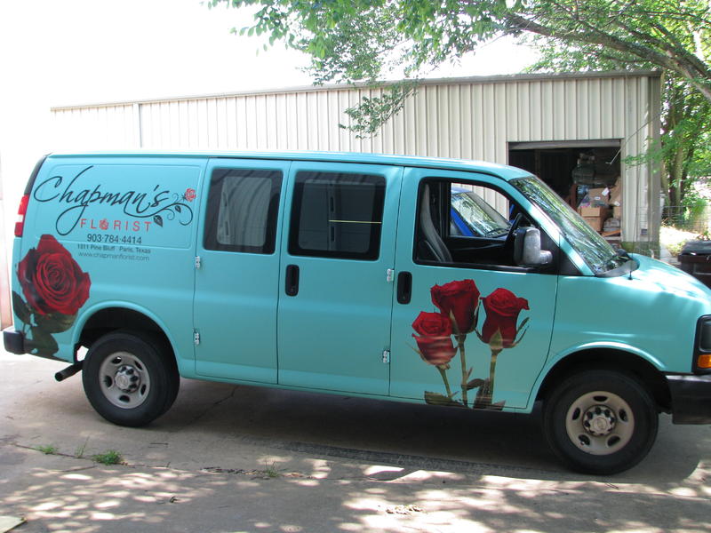

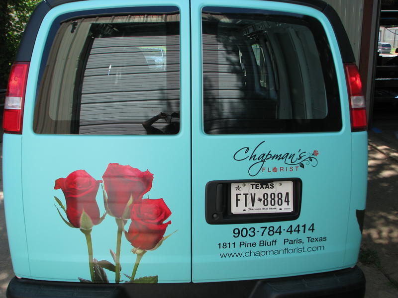

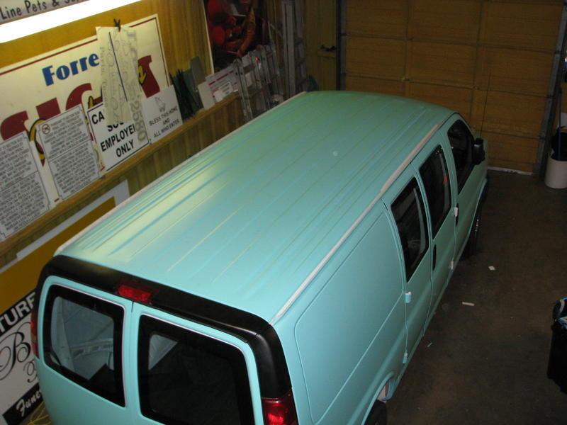

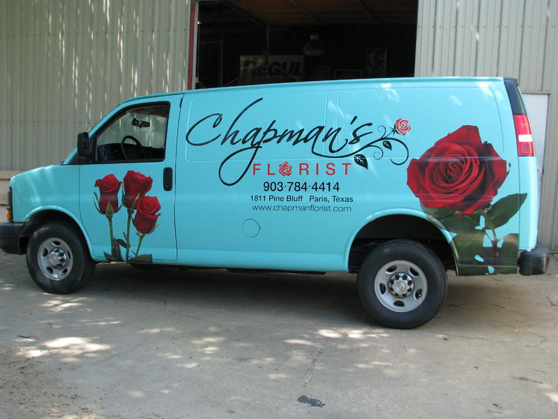

Just a quick question, How long should this have taken me? One person, Oracal 970 Matte Mint With Printed Oracal 3751 Graphics Lammed with 290...2014 Chevy Express. Full roof as well

With the full roof plus everything printed is an overlay that gets applied separate I'd be more like two full long days on that, especially once I add in the extra time to thoroughly clean the roof which you know is dirty as all get out....

Thanks y'all. I clocked right at 26 hours for cleaning(it was way dirty), wrap, print, lam, cut and install graphics & post heating the crap out of everything...Which seemed a little long but i'm overly critical especially on the deep recesses. But if a things worth doing it's worth doing right... And no the matte mint was not my choice but it really grew on me as it went.
