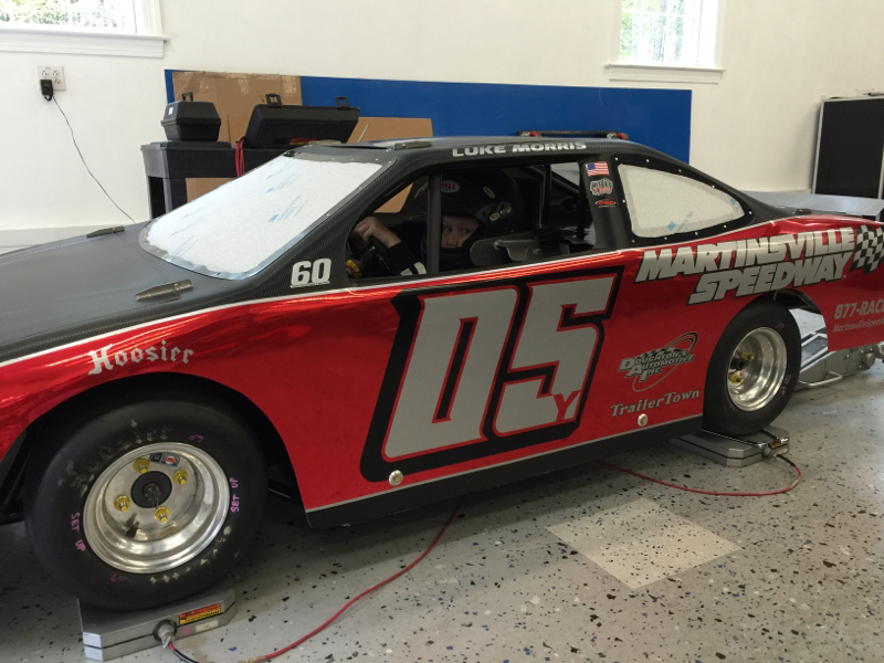

I wrapped a race car in Avery's chrome red. Since it's a round track car, I didn't stress about it being perfect(because it gets scuffed up quite a bit). It's definitely different than other wrap films. It can't be stretched as far and is harder to hide seams. If you do stretch it or heat it too much, it will discolor. I'd take a piece a scrap and play with it first to find its limits before going to work if I were you.
Here's the car I did. Top is 1080 carbon fiber.

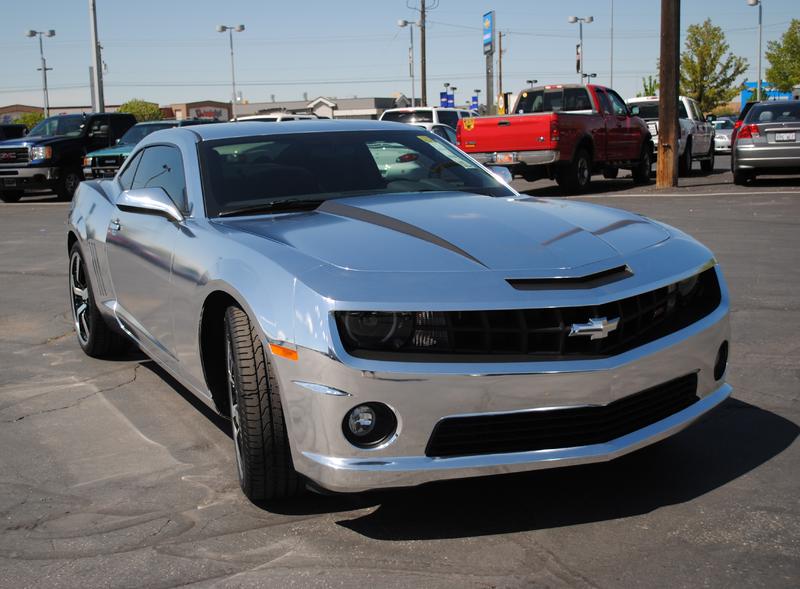

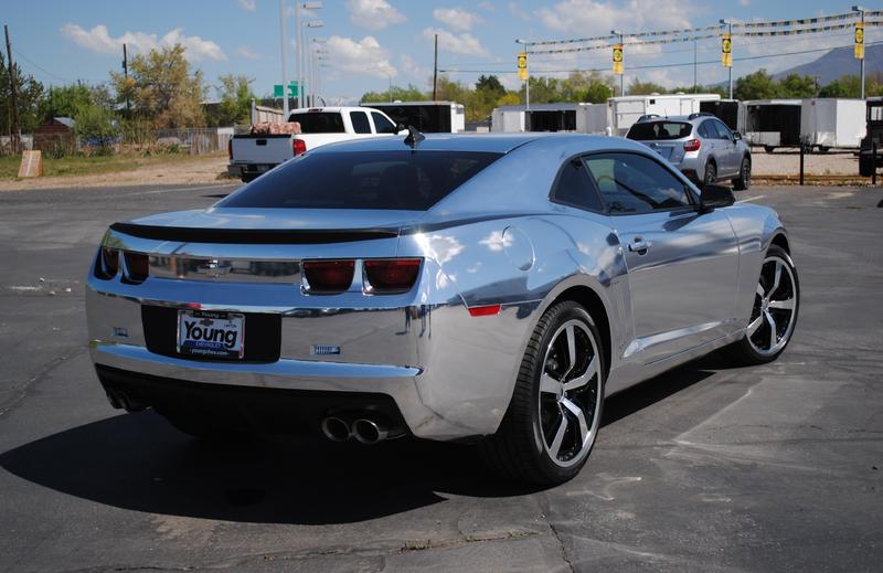

3M chrome? You mean the one they had out for just a very short period of time and discontinued a year or two ago? Anyways from everything I've read or hear the Avery chrome has been the best one out there but a few others are just getting out that are supposedly also pretty good like Arlon. I know many actually laminate the Avery chrome with a good cast optically clear laminate to reduce scratching and definitely use a geek wraps squeegee.
Chrome is definitely hard to work with. There's very little stretch and once you stretch it too much it whitens and it's toast, you can't hit it with a heat gun and start over. I'm not sure that you'll be able to do the front bumper on a Sky in one piece, they're pretty damn rounded. Since that's a smaller car the 48" width it comes in might work for the entire vehicle, but in the Camaro I did, I had to throw on some matte black accents to hide the seams on the hood and sides. So keep that in mind, if there's an area you just can't get in one piece then try to throw on some accents (it'll look a lot better than showing a seam).
I tried to install an unlaminated trunk first with a wet Geek Wraps squeegee, but even then it scratched. Hell, even my knuckles would scratch the stuff if I dragged them while squeegeeing. We laminated with Oracal 290 to protect it during install and extend the life a bit and it worked great. Also be very careful with heat, even after it's laid on the vehicle it'll whiten pretty easily if you get it too hot.
Good luck.
