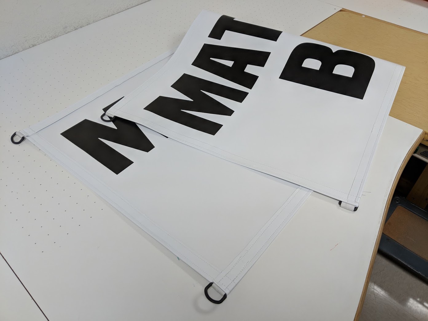

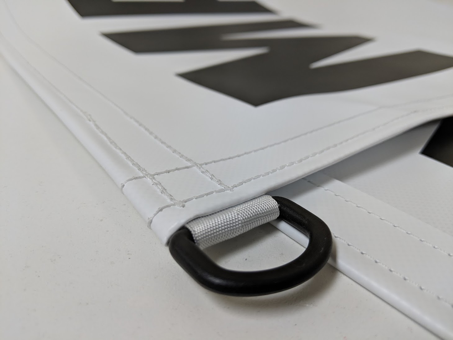

Here's a quick example of a small banner job from last week: 18oz blockout w/ 1" preshrunk nylon webbing & mil spec D Rings. It took me about 15 minutes to finish (as opposed to 5 minutes for a regular banner). Reinforced banners take a bit more effort to finish and 18oz banner costs more, sure, but it's not that big of a deal (or at least it shouldn't be).
Tip: Polyweb sucks. Go w/ preshrunk nylon instead. Much easier to work with and it won't shrivel the edges of your banner after being exposed to the elements. Also use preshrunk thread, and high quality D/O rings). It's only expensive if you're not buying in bulk. Check around online for material/hardware suppliers if you're making them yourself, or look for a textile processing facility if you need to farm it out. I make my own banners in-house, so I can't speak to any of the suppliers mentioned in this thread, but they're out there.

Sorry I can't give you my supplier for the nylon webbing and stuff. I just buy the leftover "scraps" (i.e., 300ft, 800ft, etc.) from a mil-spec textile manufacturer that would otherwise require a 50,000 yard minimum order. I get a great deal on it, but there's barely enough scrap for 1 sign shop. In any case -- wherever you get your webbing -- choose nylon over polyweb.
