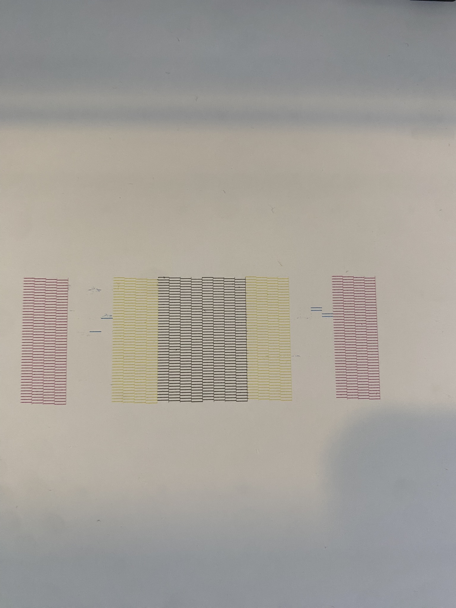

My test prints on my new printer head work but cyan not that great.

Run a 20 min nozzle wash and possibly a ink fill under the maintenance menu. Also, you may want to verify you have ink in the Cyan damper.

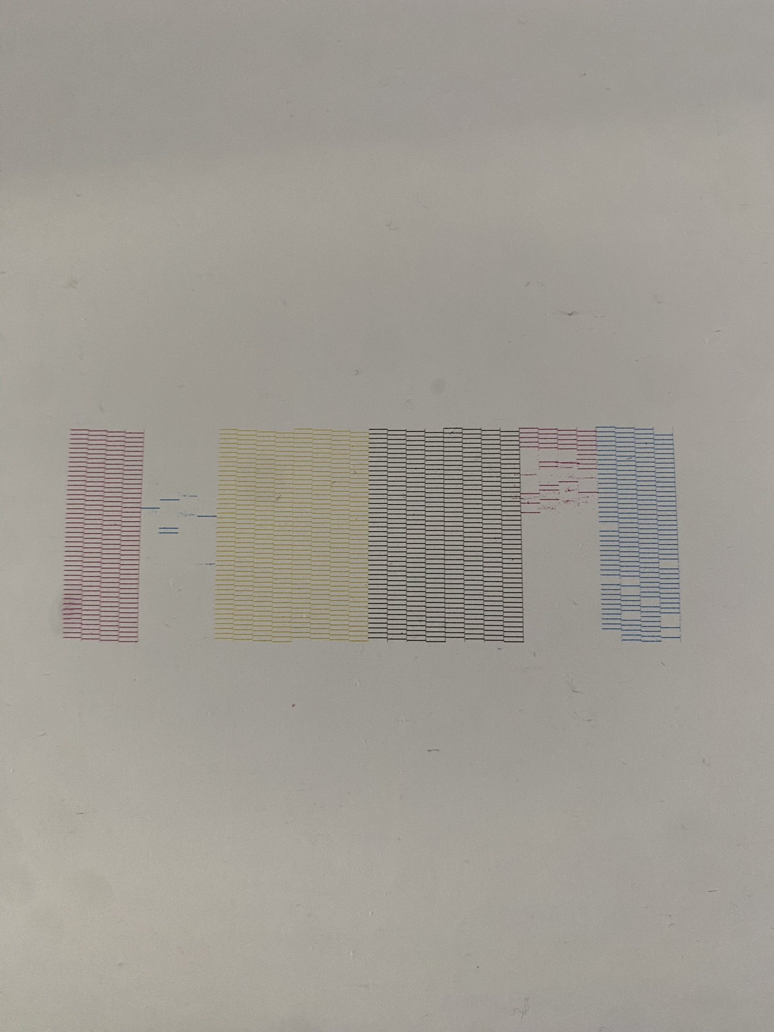

But nothing is fixing my cyan issue. New dampers, new ink lines, new pump, new cap. The dampers have ink, nothing still

Probably gonna need a new print head. Or try adjusting the capping station. Has the nozzle test print pattern remained the same or have there been changes.

Cyan barely makes any lines and sometimes none at all. If I take one of the cyan dampers and plug it into another spot on the head it prints the cyan. Before I switch the cyan to another spot on the head

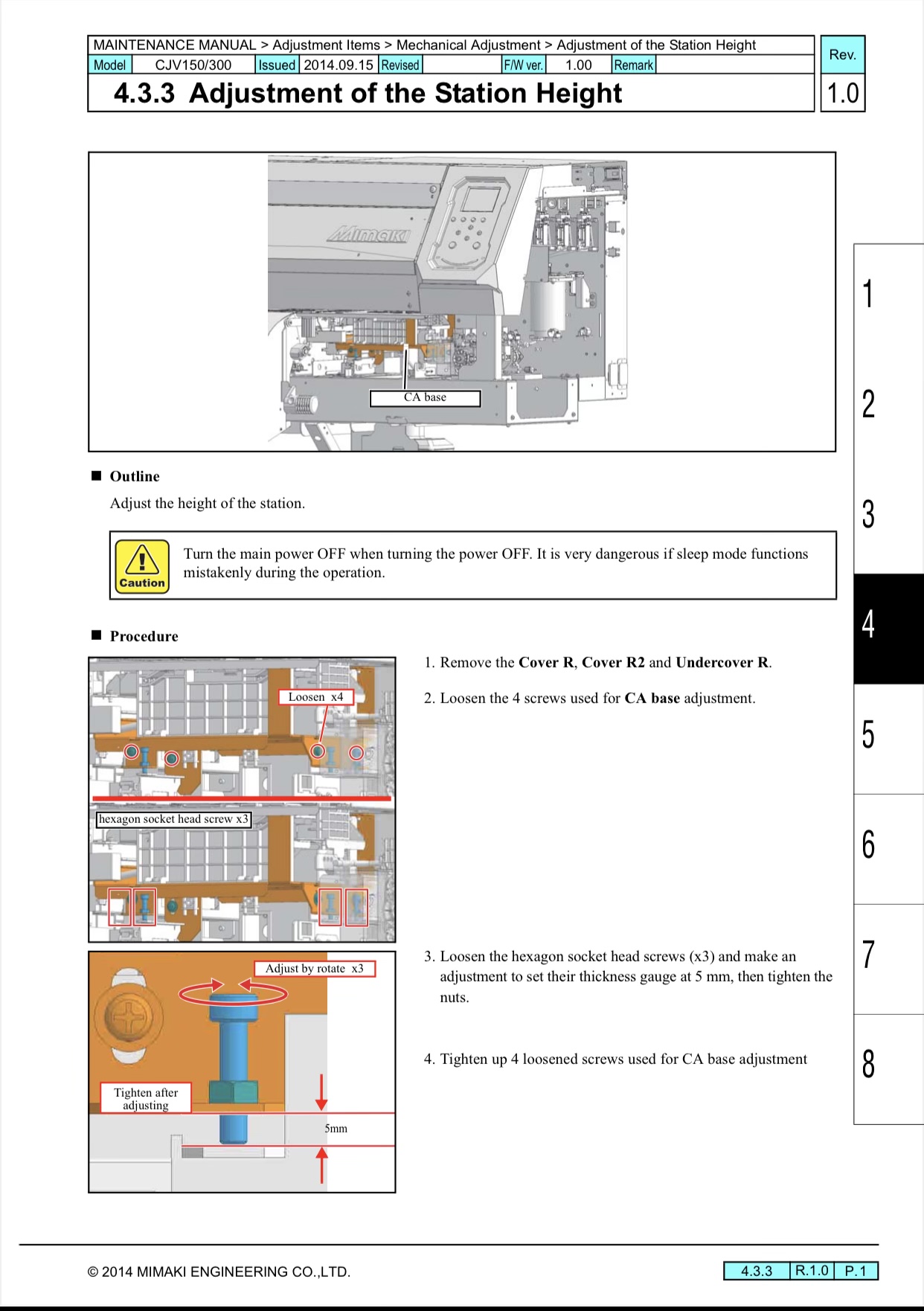

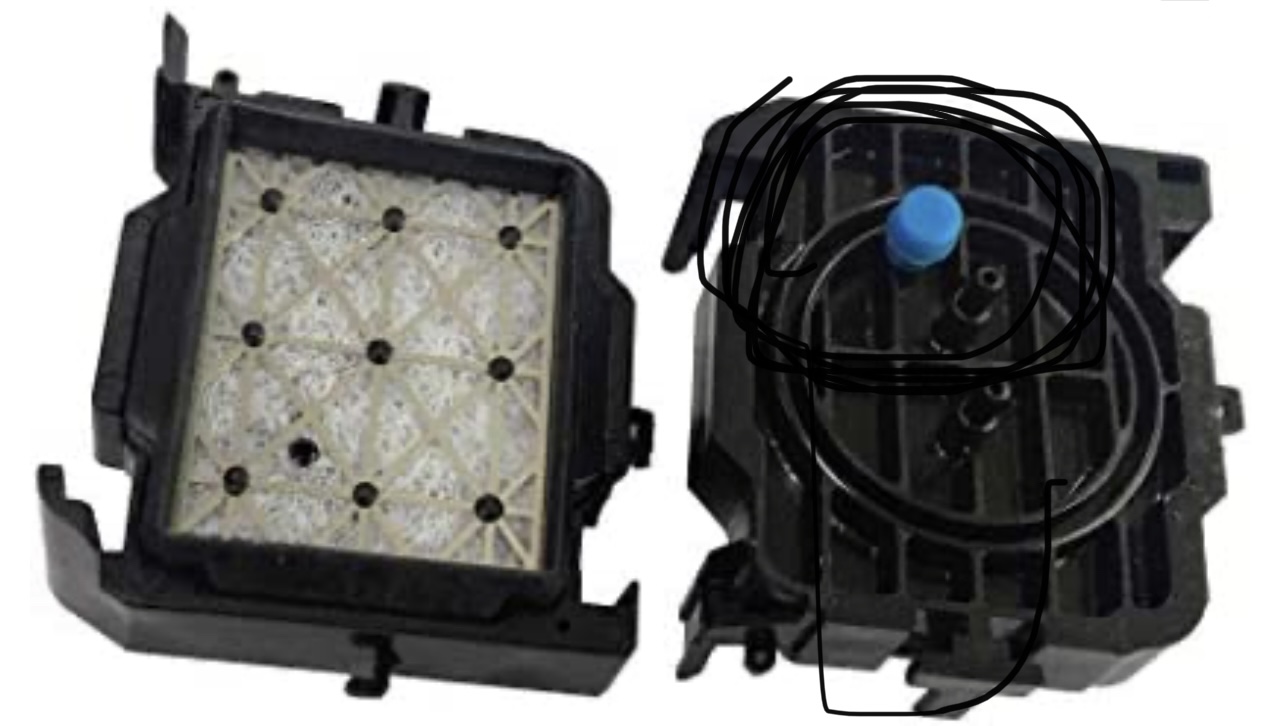

Have you tried adjusting the cap base? You may need to raise it up a bit to give you a better seal. See attachment. Also, when you replaced cap verify the third staggered port on the bottom is capped. New caps don’t come with the blue or black air port stoppers. See attachment.

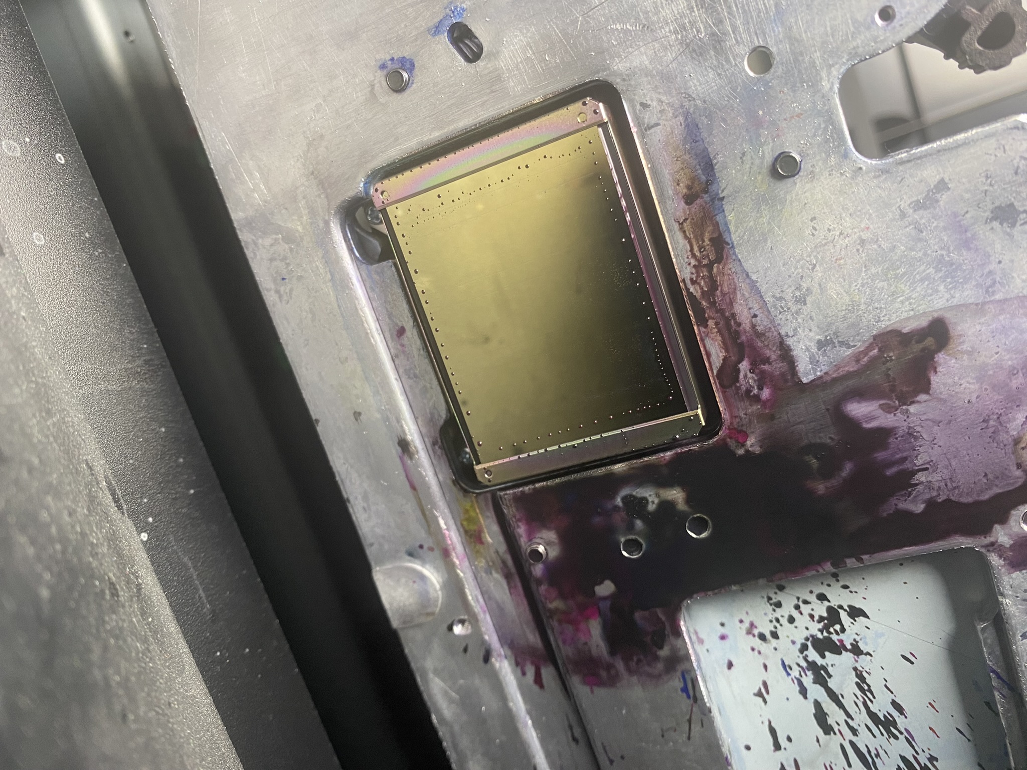

Air port stopper is on and I was told the seal was good. I had no gurgling when I pulled air from it using the tube under it and this photo of the head ACADAA84-2D95-450E-BD07-015258F0C190.jpeg

If this was a Mimaki OEM head you should have a 90 day warranty on it. I would just replace it. Verify the head cable are seated correctly too.
