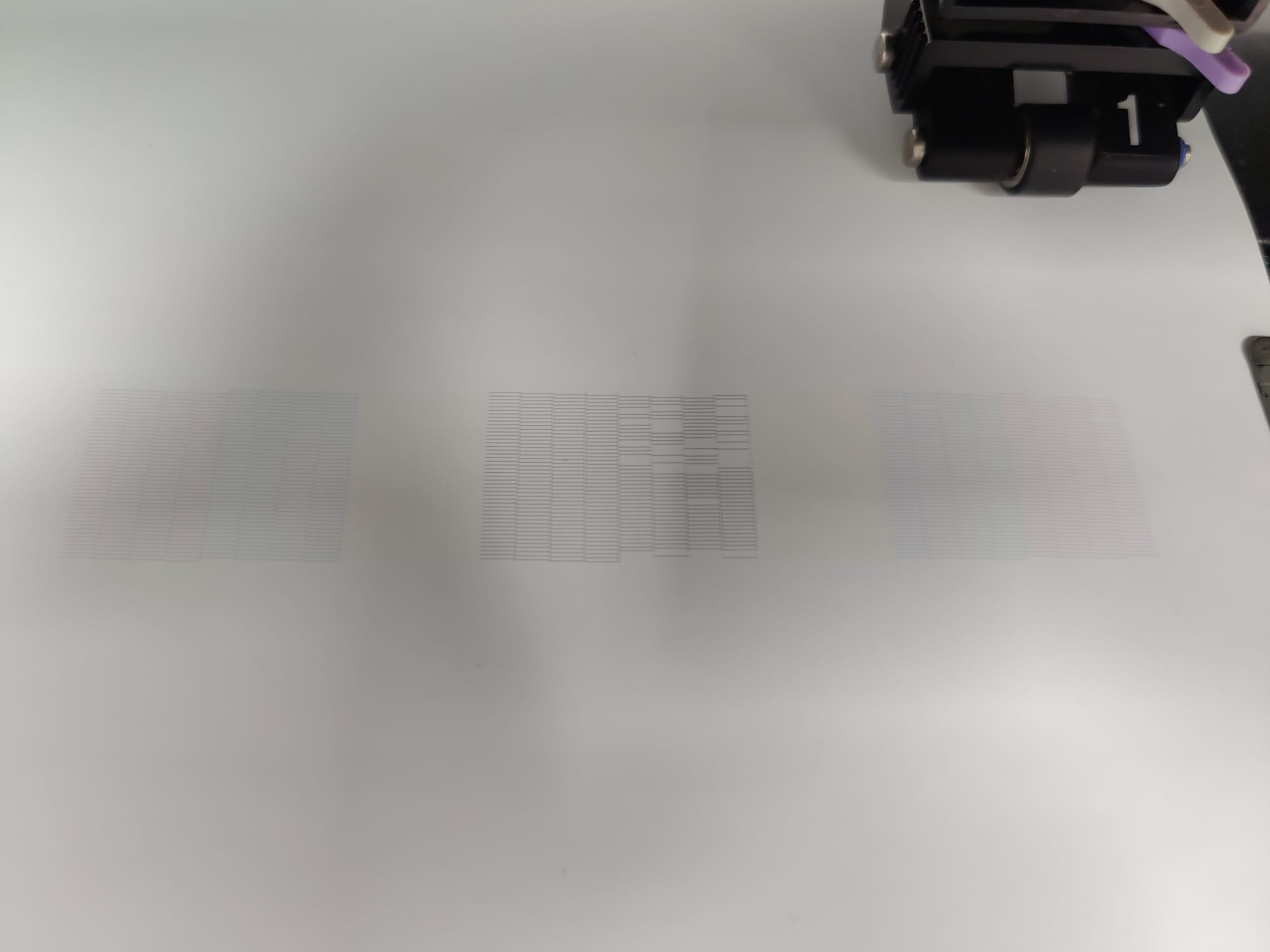

Hey,
i flushed my Black line from the Head with a syringe and 50/50 MEK/Mimaki Cleaning Fluid after that if done an ink fill but he wont print black only a few nozzles
Damper is full and there isnt any black in the cap top after cleaning and ink fill did i killed my head ?

MEK. Wow. I don't like your chances.
What was that channel like before you flushed it?

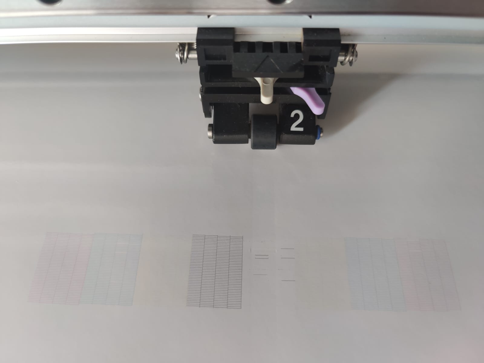

Before flush check picture
i filled the Head manual with black color after that he printed looks like he dont get suction

Neil
Do you get ink pooling in the cap and visible on the wiper during/after a normal clean?
So if you put black ink into the head it prints a good test print?
It might still be okay then?
If so, it's either not sealing when cleaning (but you said it does pool ink), or it's something above the head like damper, carts, ink related.
Try swapping dampers with say cyan and see if the cyan will print through that channel.
