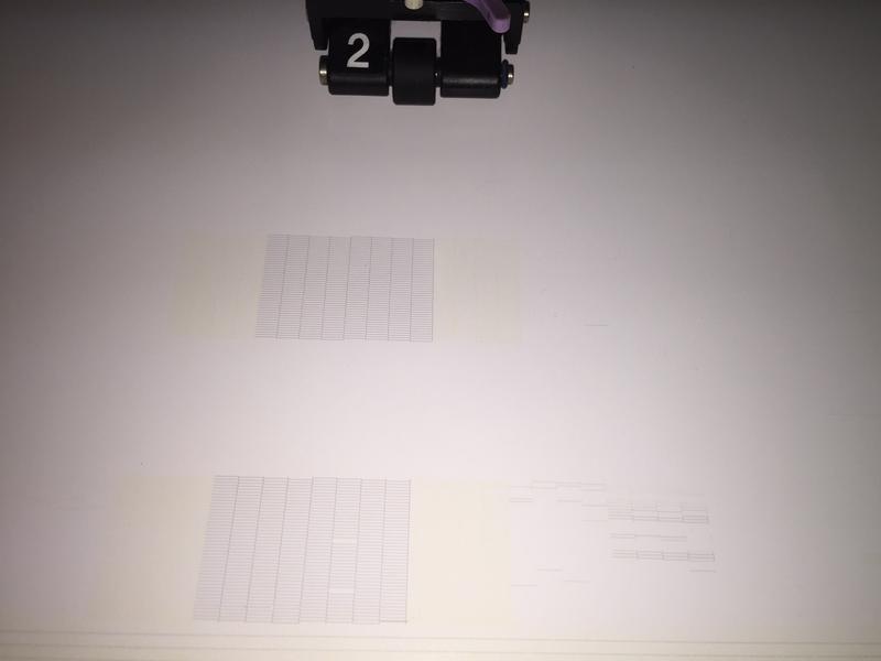

Now comes the strange part. To saturate the cap station, I did an "Ink Fill Up". Ran another test print. Missing far left magenta. Soaked the head again. Now missing all magenta. Another ink fill up. Missing the Cyan. Only the yellow and black are printing fine. Nothing comes out of the magenta and cyan. Two days ago, perfect prints. In the matter of less than 60 minutes, I only have two colors.

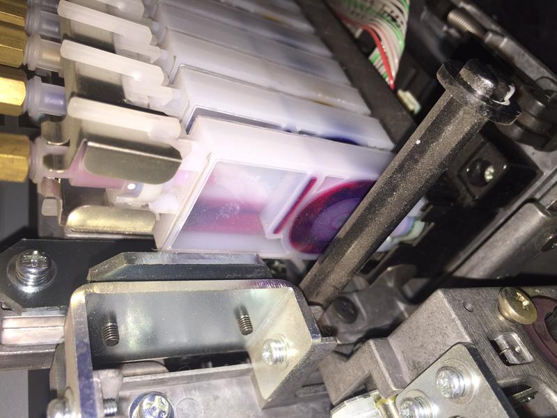

Not sure if the dampers are needing to be replaced. Not sure what is going on. Ink appears to be in the lines. I followed the JV33 capping station replacement guide, very easy. Head itself appears to be fine. Nothing stuck to it. I have a feeling the ink just isn't going through the lines but I have no idea. Luckily, this is happening during a lull in printing. Any help would be appreciated.
Dampers
Test print

I would test the pump first to make sure it isn't clogged. Even if the cap drains, one side may be clogged and that will cause the issue. Use a syringe to push solution through each waste tube into the waste tank. If it doesn't flow all the way through, try to work it so you can break up the clog. I can see Cyan in the Magenta damper which means the damper could be failing but usually I see this when the cap top is bad or the pump is clogged. Also, make sure you put the blue stopper on the third hole in the cap top. If that is not on, it will cause problems.
If the pump is not clogged, I would move on to changing the dampers. It is possible that they are clogged or malfunctioning in another way. If the pump pulls on the damper and nothing comes out, when the pump stops pumping, the damper will suck some of the ink in the cap top back into it. This could cause the cross contamination.

No improvement since yesterday. Washed the pump as well with 10ml of wash fluid. Any other input is greatly appreciated. Thinking we are going to replace the dampers and pump then call a tech if this doesn't fix the issue.

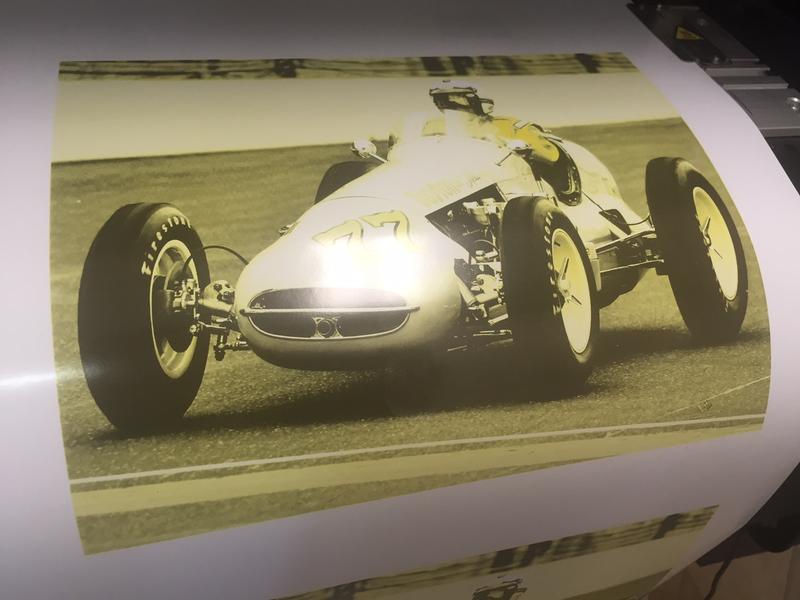

When trying to print a full color image, only yellow and black...
