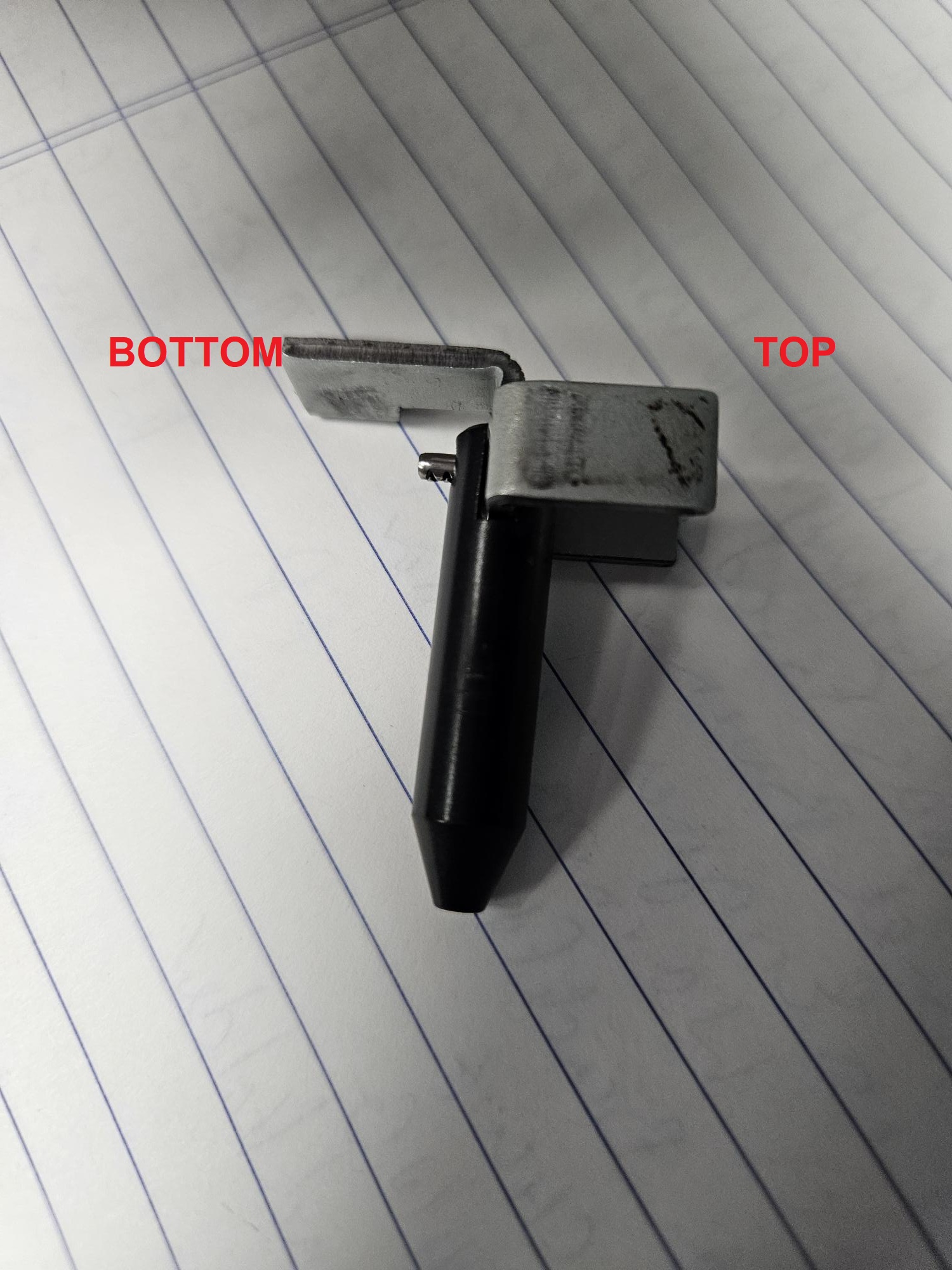

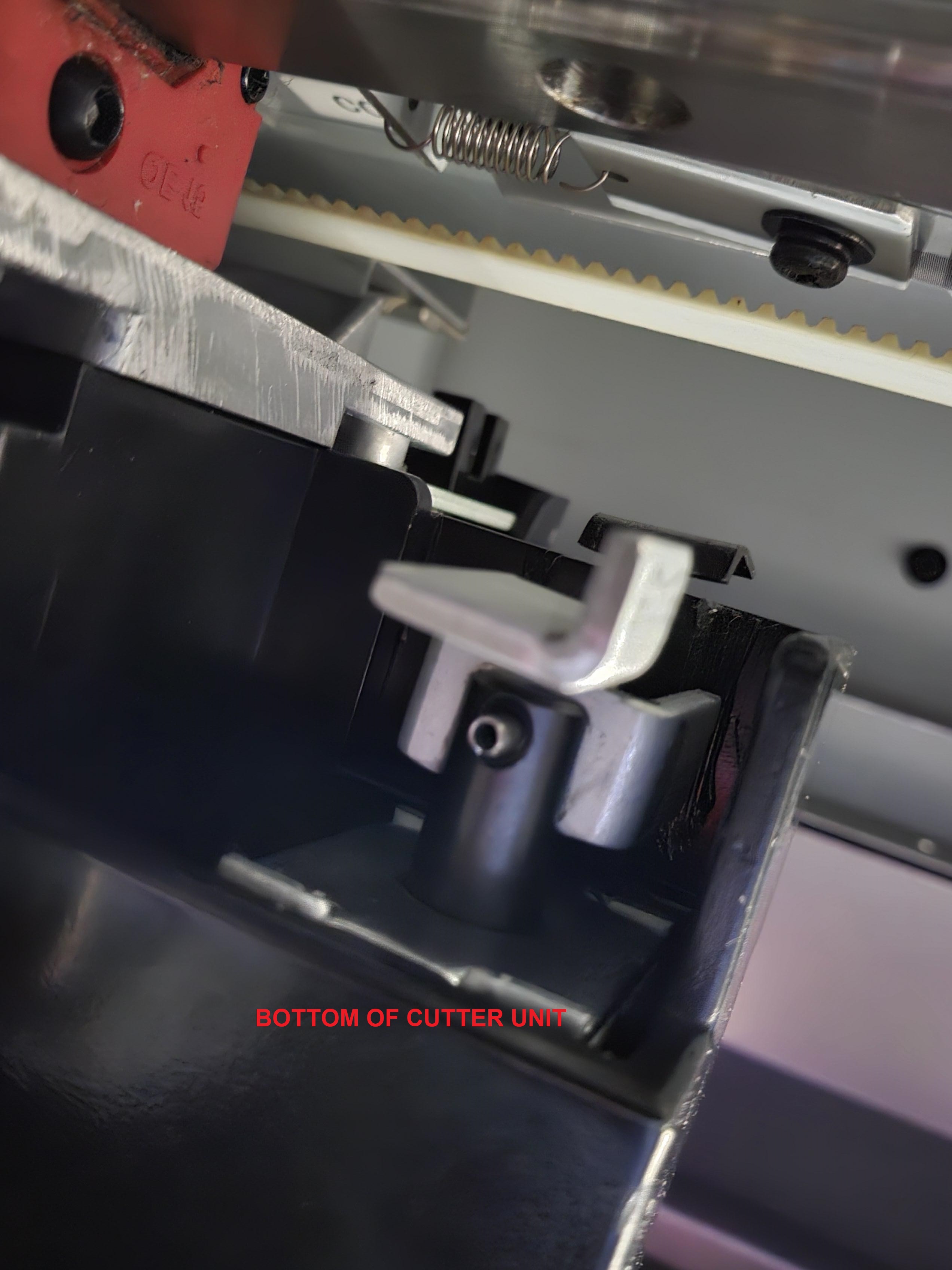

Hey!
So this happened to me yesterday and I scoured the internet looking for a solution and came across this problem. I just wanted to upload a photo of the piece that had come loose and how it sits in there so that if this happens to anyone else at least there is something somewhere. I got the "c head home pos error" message and when my metal guide piece went to attach to the cutter unit it was snapping and wouldn't attach.
I took the black plastic cover piece off that the metal guide piece clips to, and there was a hole going horizontally where I placed the black heavy pin-rod thing, the "Y" piece is oriented up and the "L" shaped piece is oriented down. This allows it to turn/swing as it needs to to clip into the metal guide piece.
