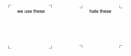

Just replaced our CJV30-130 with a brand new CJV150-130 and it is giving us more issues than our old machine ever did. We print something, with Mimaki reg marks, run it through the laminator. Then we feed the "leaf" back into the Mimaki. It is incredibly finicky on this part sometimes it reads the width then pulls the whole sheet through and stops at the end with the screen stuck on "detecting media" Then should we actually get passed this part it has another 33% chance to do a weird thing when the cut file is actually sent. The sensor reads mark 1 good, reads mark 2 good, then movies itself an inch or so to the right, pulls the sheet through and looks for mark 3 but it is still and inch or so away from where it read mark 2. This should not be this difficult on a brand new machine!
