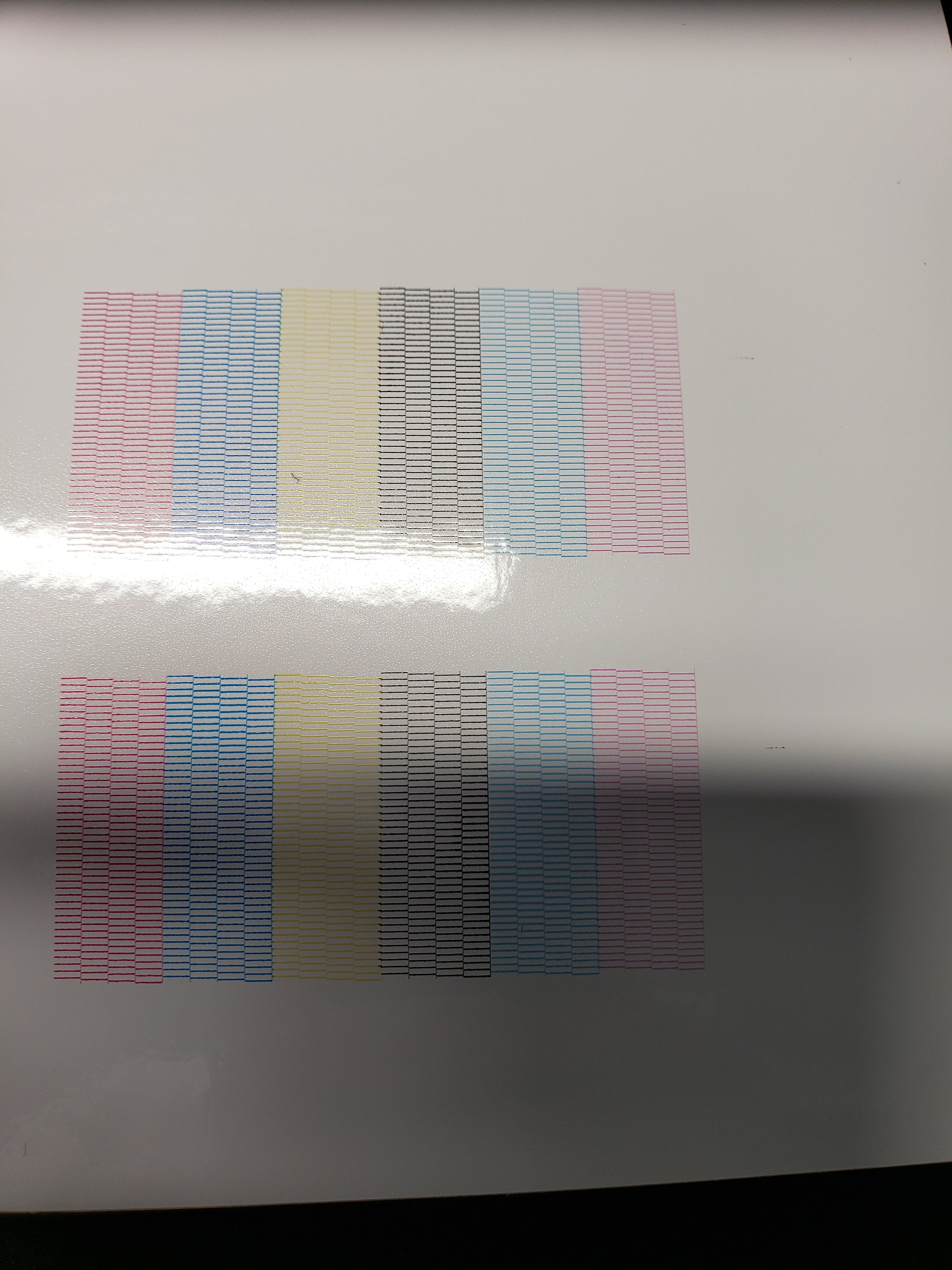

I'm running an 8 color set up with C,M,Y,K,Lc,Lm,Lk,Or. I did a nozzle soak for one hour to no avail. The printer kept saying my orange ink cartridge was expired. So I installed a new ink cartridge for both orange and light black, but still to no avail. I'm still pretty new to this. I bought this printer new last summer. Any advice or help would be appreciated.
The test print doesn't quite look right in the photo, but in person all other colors look normal.

Do an over night nozzle wash. In the morning one ink fill. one soft clean.

Do you see ink in the lines above the dampers? Did these colors slowly go out or just stop printing out of the blue?
