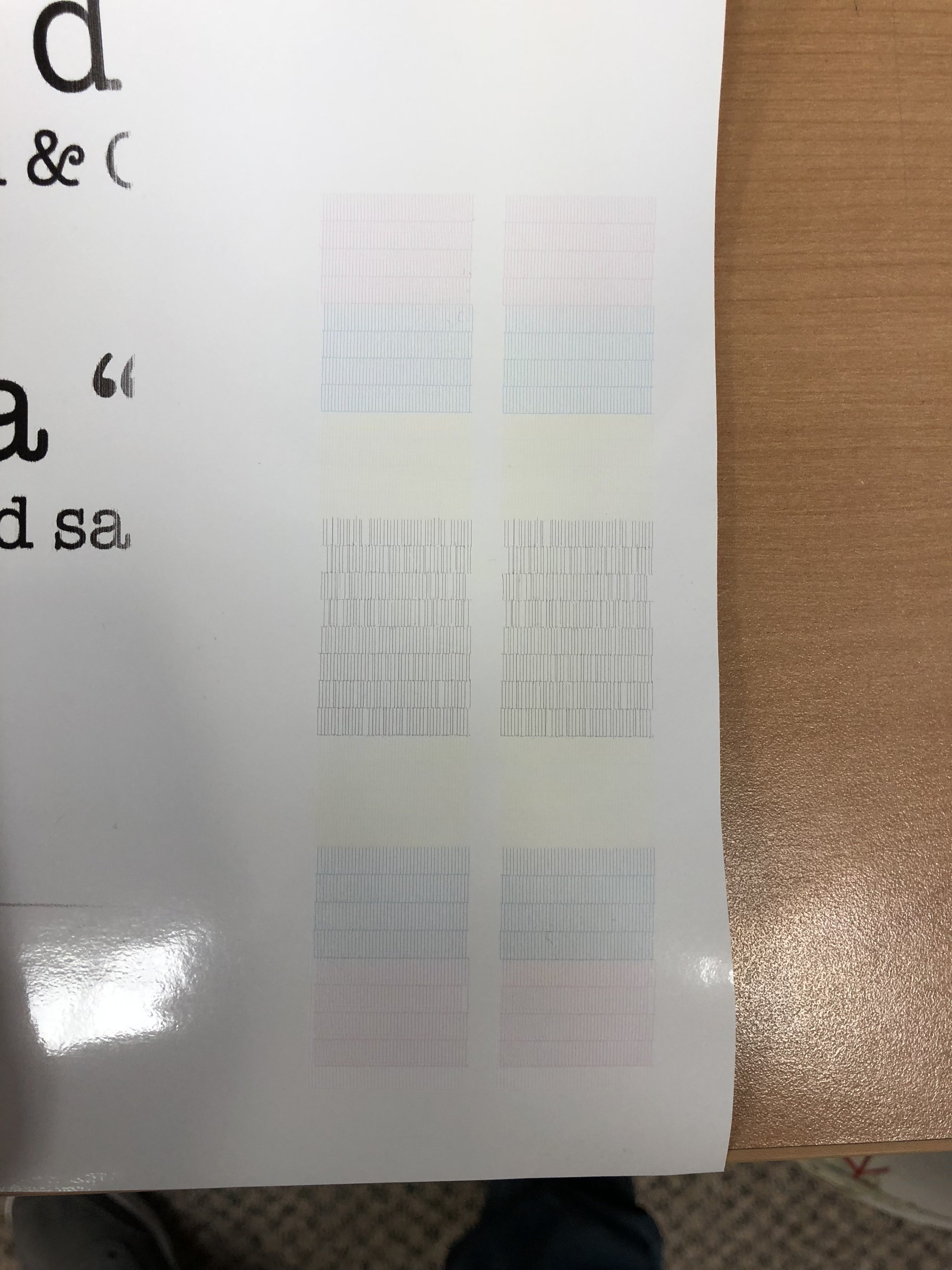

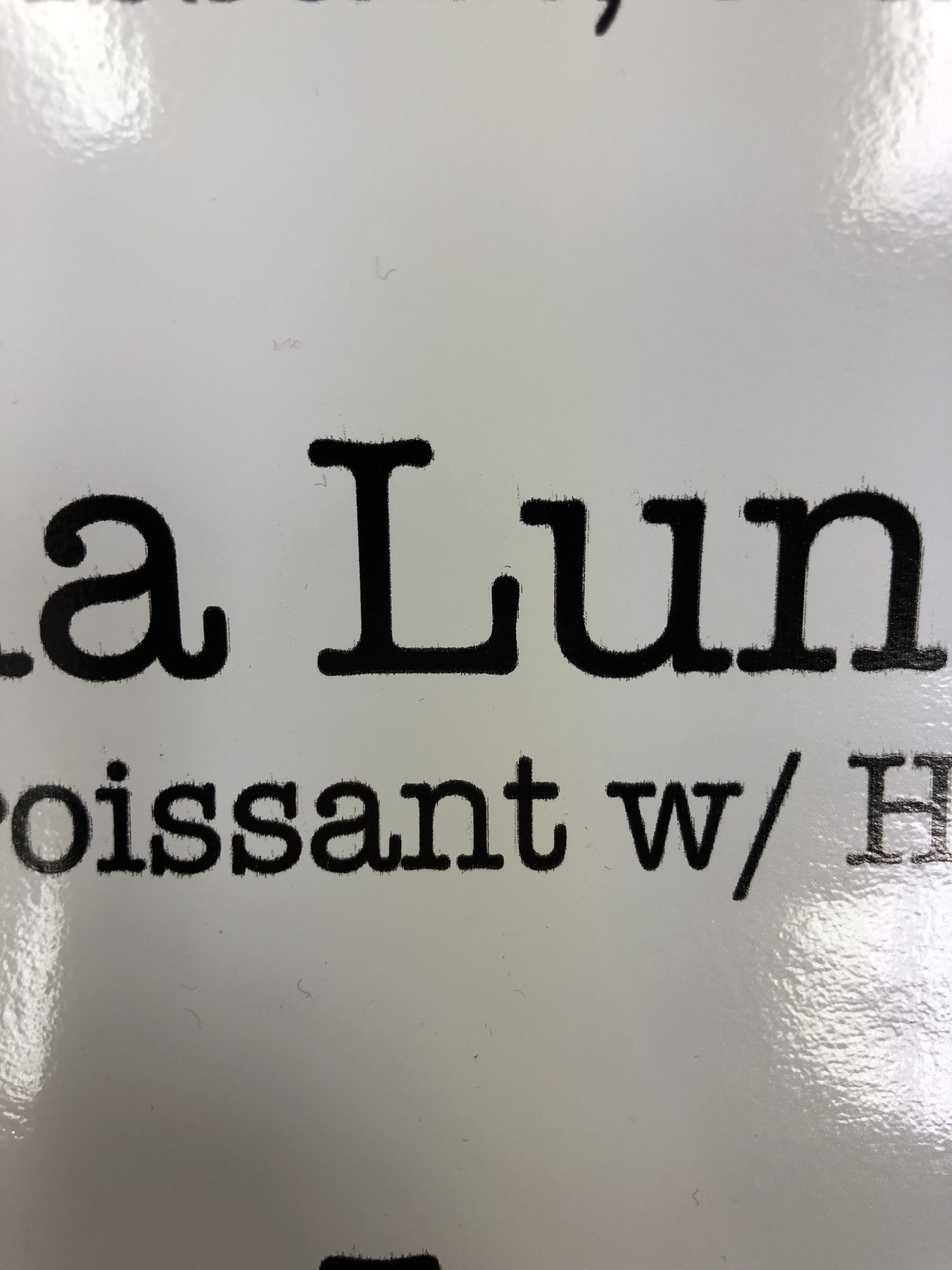

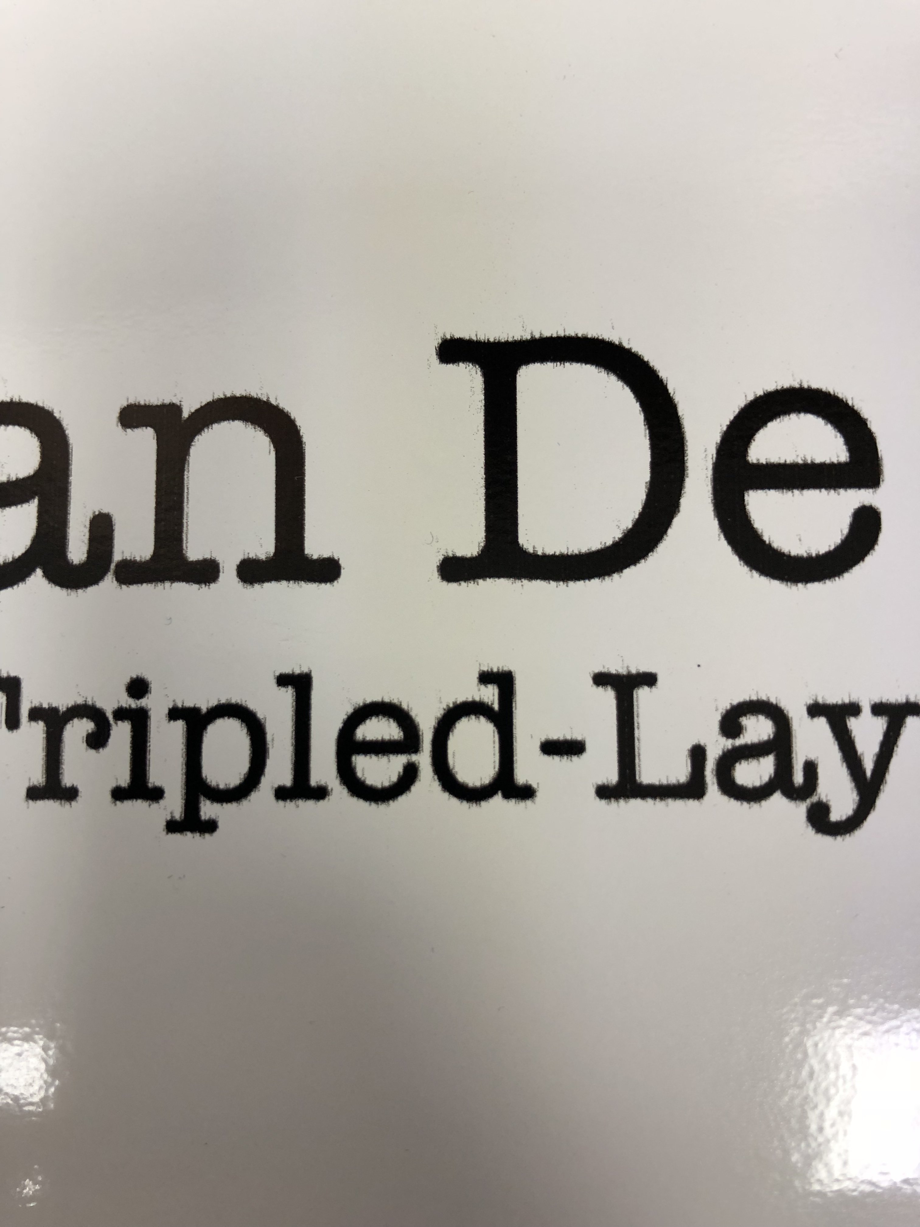

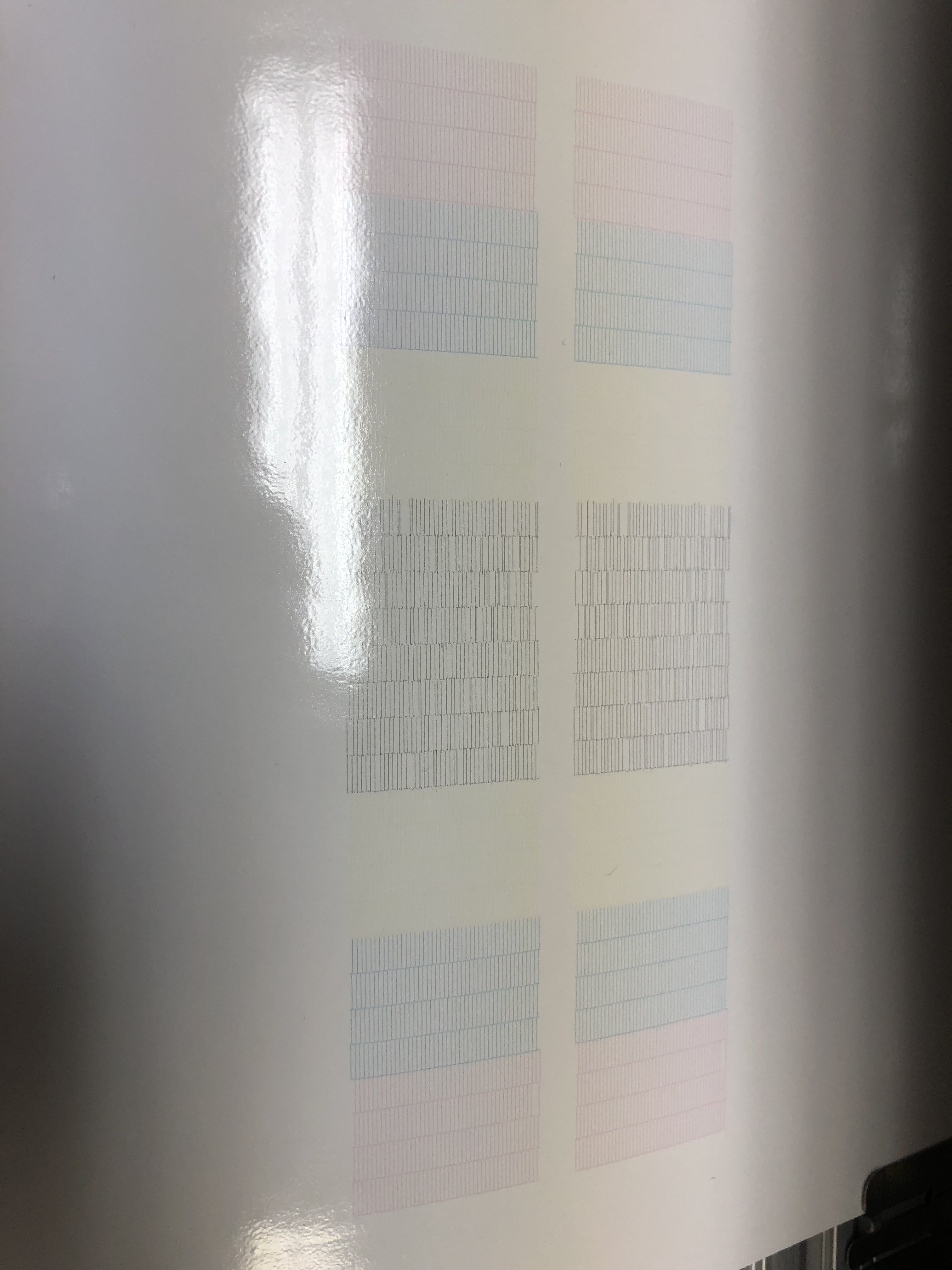

Have been loving my mimaki for 6 years but she is starting to finally get some fuzzy/grainy issues with blacks and some other slight streaking issues.
I have been looking into a DX or Chinese head replacement myself but just wanted to find out if anyone thinks these test prints show we need a new head or can possibly fix it another way?
Any help is much appreciated

the nozzle check is sketchy, but your printed lettering looks like it could be the heater/dryer not being hot enough. how old is your captop and wiper? Is the flush position set correctly?
RL67POLO
Those lettering prints were on gloss8 setting in rasterlink and I believe bi directional ( whatever is the standard one for vinyl we only use the other setting for banner) I will post back tomorrow what setting it was

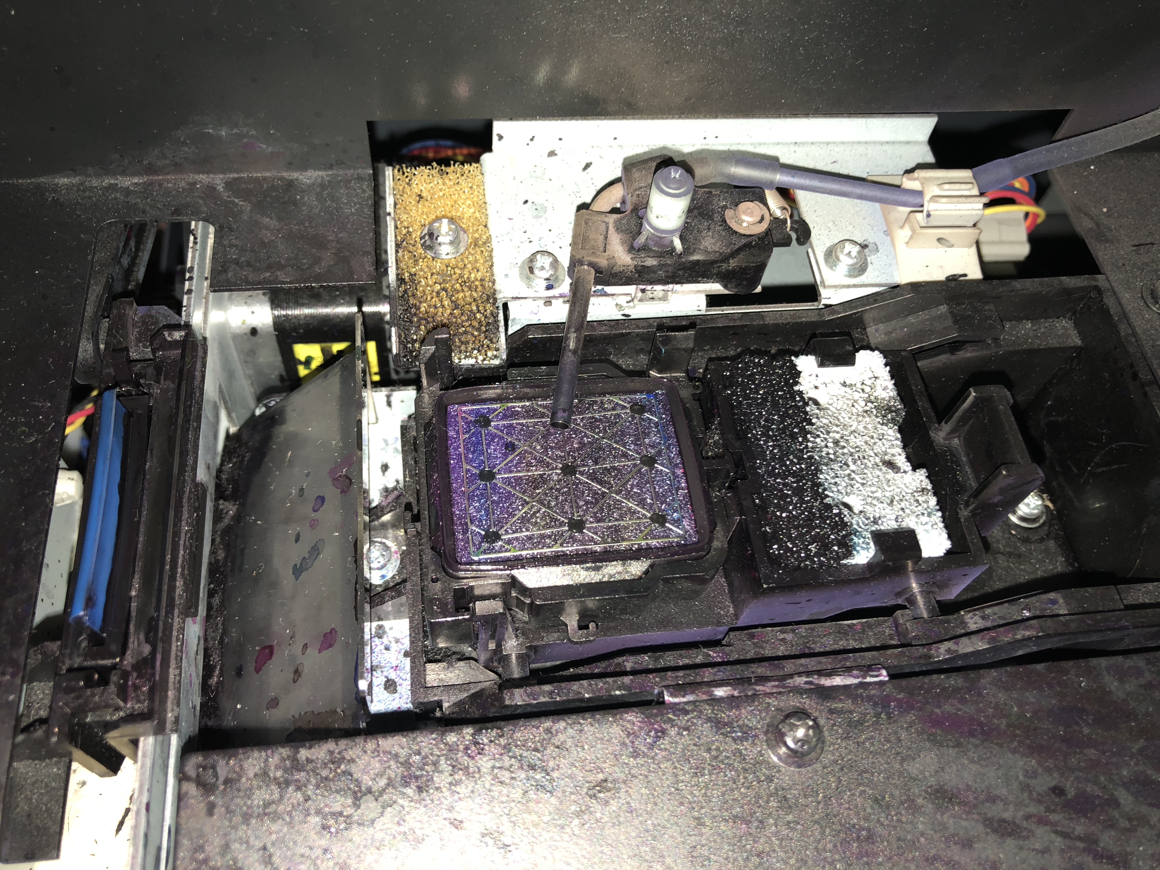

I can take a pic of the captop and wiper - the sponge is pretty juiced that is all the way to the right with black ink which makes me
Wonder if it’s not the head. Will post some pics up tomorrow

i would look at the gap between the head and the material the best you can while its printing and see if its dragging ink around with it. Temps for a glossy vinyl probably around 40C on the print dryer and 45C on the post dryer.

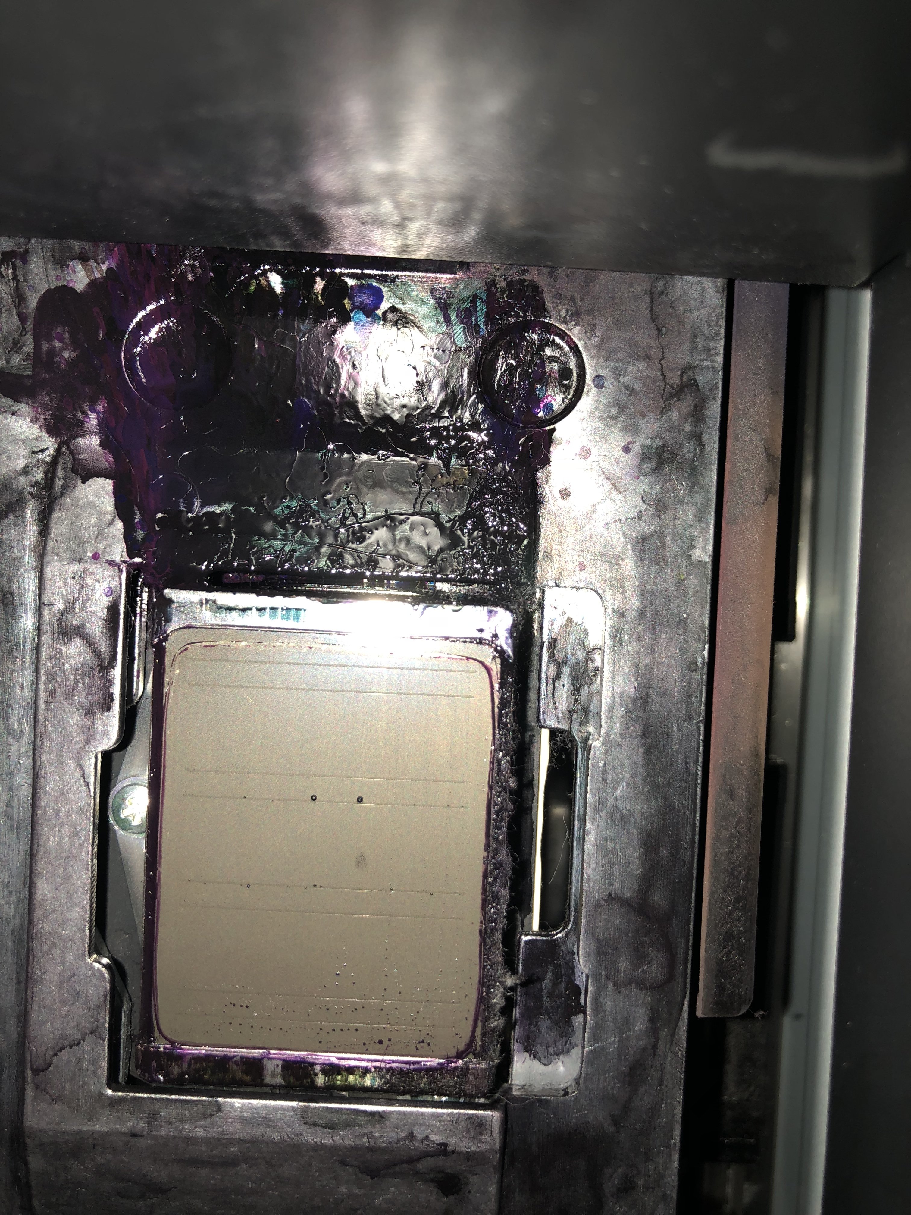

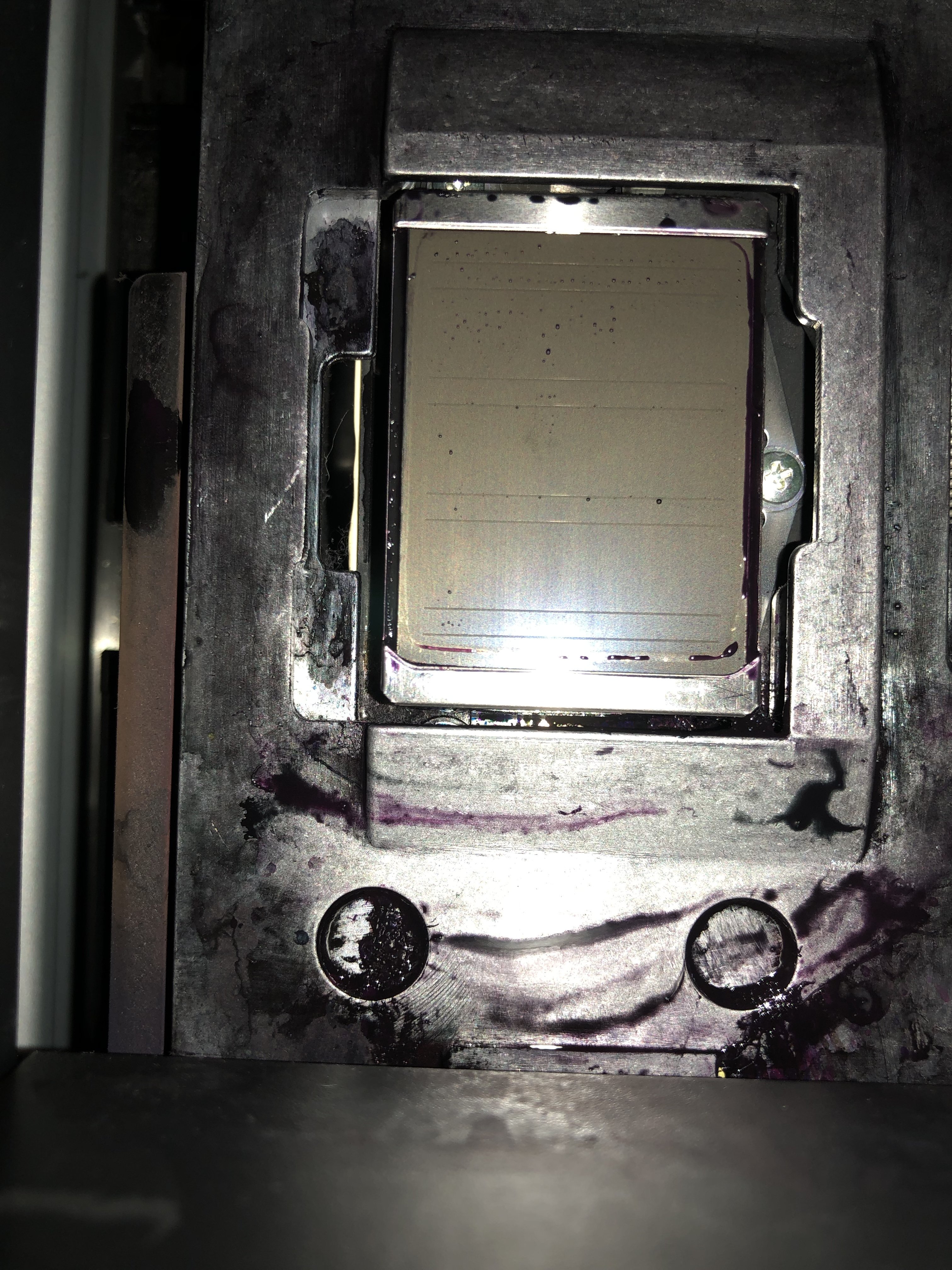

I did take a before and after cleaning pic of the head tho - attached are capstation ( head pic before and after) and test print
Still wondering if we need a new head because the mimaki tech says that is the only thing to fix it. It’s a shame it’s just the black

The black is definitely deflecting and judging by the nozzle check it is probably unrecoverable. If you look at the bottom of the head you can see how pronounced the nozzle lines are. That is usually a sign of an older head. You could try flushing it to recover but it's a gamble.
Also, 50/50/50 is way too high for heat settings. It's different for every material but you should be closer to the mid 30's for the pre and platen heater and then you can crank the post heater up all the way to 50.

That printer isn't cleaned months....I bet that if you clean your head bottom and cappingstation,head soak and hard cleanings sometimes, print 5-10sqm.... the head will come good!!!
P.S. Also the wiper is so deformed...

Replace your dampers, cap top, and wiper. Give it a good weekend head soak and see where you are at before buying the new head.
