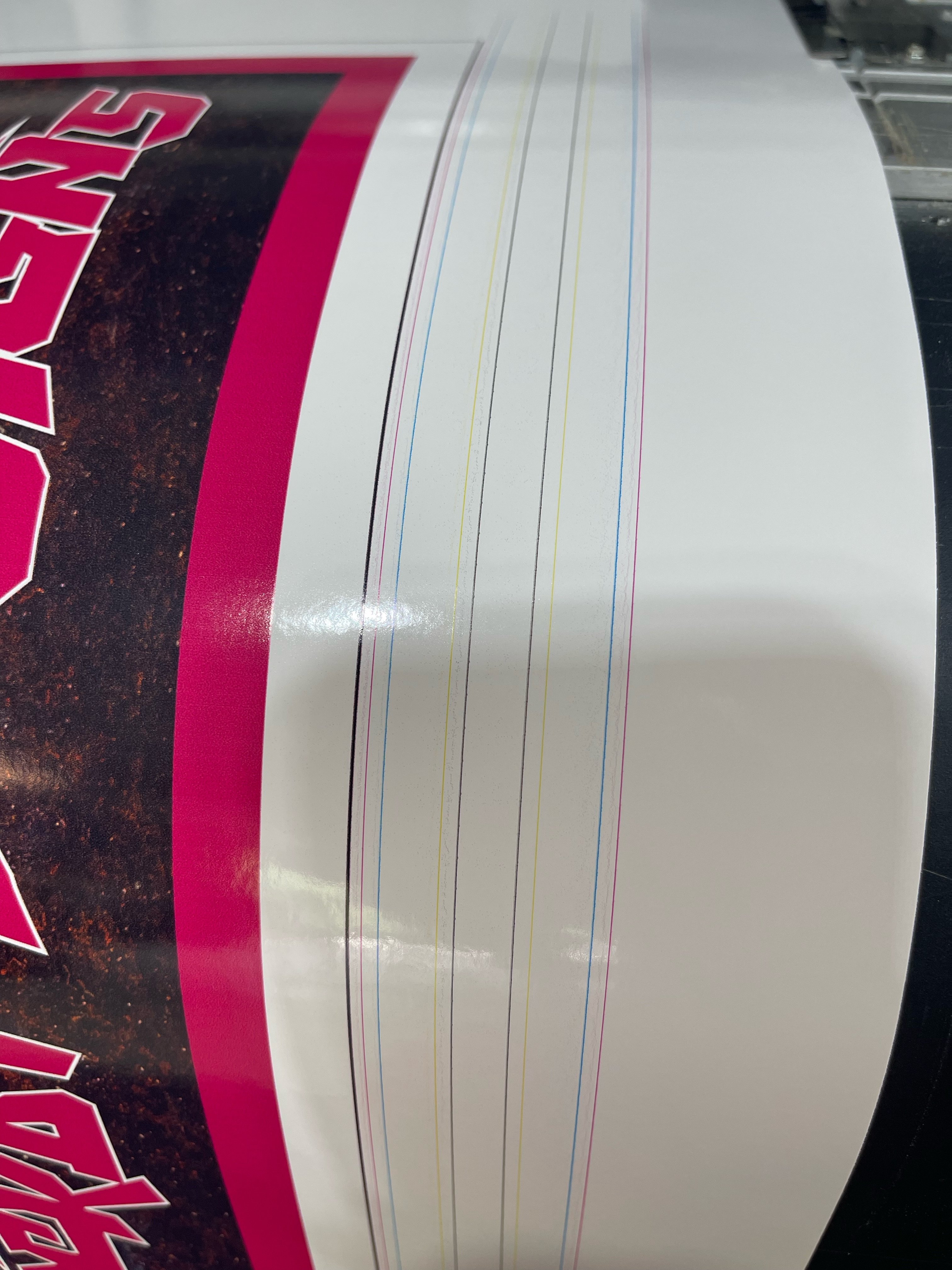

My Cjv 30-130 was printing a banner today and in the middle of the print it started printing color lines on the outside of the work area. Everything is still working fine and still printing its just printing the extra lines.

You don't have the "color pattern" turned on, do you? It prints color bars down the right side when on... Mine doesn't look like that, but it's something to check, it's buried somewhere in the menu on the printer.
