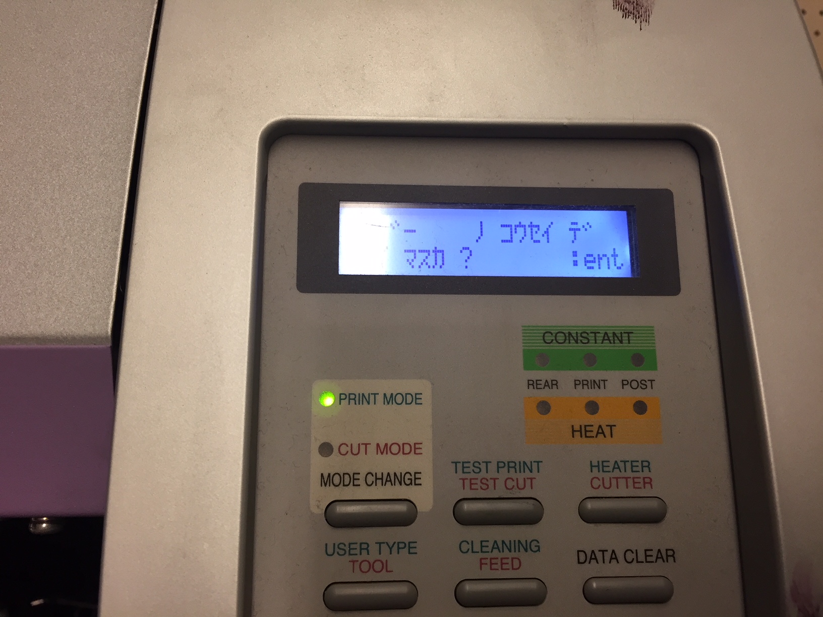

So I was printing some vinyl and decided to switch over to some banner material. After switching to banner material, I received "ERROR 202 DEVICE CONSTRUCTION". In my google research, I was advise to turn off the Mimaki and turn back on to see if the error would go away.

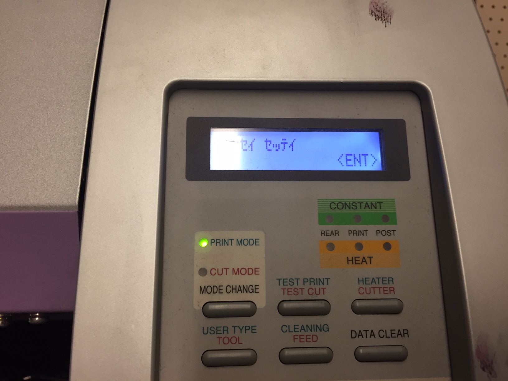

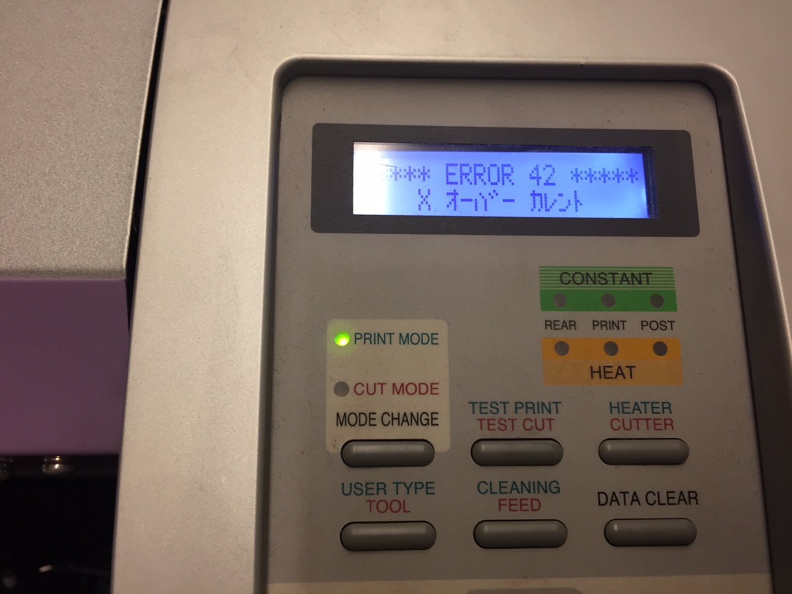

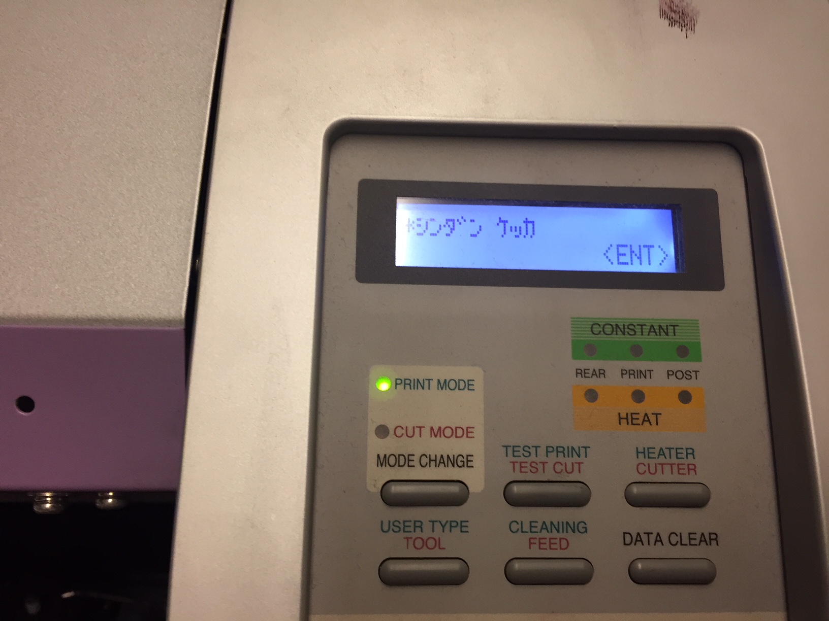

Well it didn't, but what did happen was, the language changed to Japanese? I did not change language settings. So now I get Error 202 in Japanese. I also received "ERROR 42" but after a restart Error 42 went away.
In my research, Error 202 happens if the head is not genuine, this is the original print head and was printing in the past.

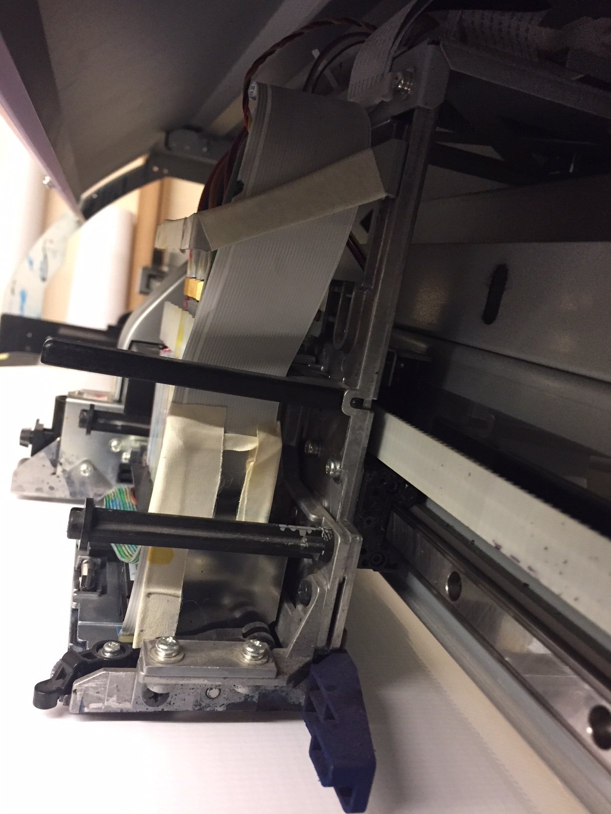

Im not too sure if the head might of disconnected when I loaded the banner material.
Any advice will help.

Yes error 202 mean the head is not genuine but it can also pop up if something is going wrong electronically with the head or even the main board. The fact that it changed to Japanese tells me something must have happened to the main board. I would contact Mimaki and ask them to send your original parameters and load them on the machine. This will reset the machine back to factory defaults so you will have to trick it into thinking it's already filled up. I can't remember which parameter it is you have to change off the top of my head but a little research should turn it up. If that doesn't fix the problem, I would be willing to bet the main board has been damaged in some way.

Did you find a solution for this problem?, yesterday my JV33 showed same problem, I think it received an electric discharge but I´m not sure, first I saw 42volt error, then 202 error, also is possible PC is not recognizing printer trough USB o maybe is not possible because printer is in error.

The 42 volt error means the circuit that controls the head malfunctioned. After that, getting the error 202 means the machine thinks the head is not and OEM due to the fact that an electrical test failed which means either the head and/or the main board is fried. The fact that the computer no longer sees the printer on USB means the main board is probably fried.
