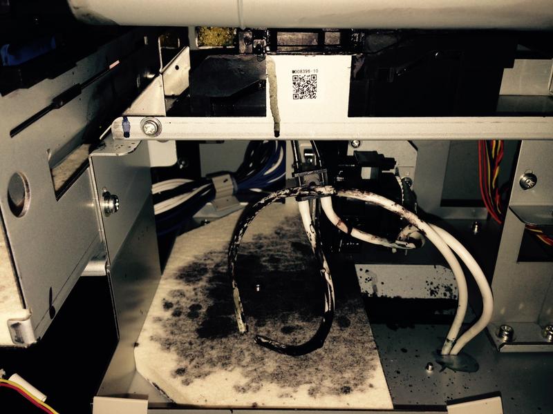

I undid the front pump cover and the issue was immediately clear, one of the vacuum pump lines was snapped! I took some photo's and emailed them to him.
Once we worked out it would take quite a while for their tech to get here with the parts, we hatched a plan to do a bit of bush mechanics, reverse the broken line, so I had a long tube to go through the pump and join the broken piece so it would act as the drain by using an empty ink tube from a ball point pen.
It took me most of the day to clean out the crud and dried ink from in and around the pump. When I finally go it back together, it worked first time, and the nice thing about the ball point pen ink tubes is that I can see if the cleaning solution and ink is moving!
It is now printing better than it ever has, the tech advised me that it sounds like it was defective from the start, and he thinks the vendor swapped the pump out for an incorrect, but similar part, as the pump I have is for an older model. This makes sense as I know they had it on the showroom floor for quite a while and I guess when they went to set it up for me they found the pump was dried up and the easiest way was was to pop in a new pump, in fact any pump and ship it.
I have found that if the left side tube (this is the one that was busted) is not secured out of the way, it rubs on the gear wheel of the pump, all it would take is for it to catch and the gear wheel could drag it into the workings and cut it and we would be back where we started!
Anyhow I have now run a nozzle wash, and a hard clean and it now is printing 100% on each color when tested! Yeh!
This is what it looked like when I removed the cover.
The area all around the capping station is also full of dried ink, when the tech does get here next week, I will be sure to get it cleaned out and I will press for a new capping station.

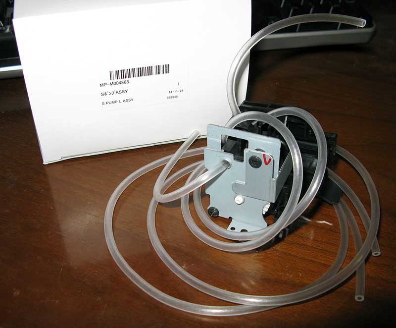

That's a mess! I'll say this much. The dealer that sold you the machine was pulling something on you. That is not an original Mimaki pump. OEM original Mimaki pumps have clear ink tubing and MANY of the cheap Chinese made aftermarket pumps are absolute junk and will fail very quickly. An original OEM Mimaki pump will generally last 2 to 4 years (or more). Someone already had some issues with that machine which is why they put a piece of junk dirt cheap aftermarket pump on it. I've seen at least a dozen pumps for Mimaki JV3, JV33, CJV, and JV5 machines and not one original Mimaki pump had white tubing. I have also not yet had one aftermarket pump last more than 6 months while OEM Mimaki ones seem to last a few years. The photo is a brand new OEM Mimaki spare I have for ours. I'd make certain they replace that pump with an original Mimaki one like the one shown. Nothing like getting your first "demo" printer and the dealer has hacked at it with crap aftermarket parts. You would think a Mimaki dealer would actually use the correct parts.
We use bulk cleaning solution from Triangle inks but you can pretty much use any aftermarket cleaning solution from whatever brand of aftermarket ink some local supplier sells which will probably be a quarter the cost for four times as much.

Genuine Mimaki pump. They do have it in stock too.
http://www.digiprint-supplies.com/jv3-s-pump-l-assy-m004868.html
It does ship from Belgium but they are pretty fast and do have fast shipping options. This is where I got the one we are currently using which I showed a photo of above.
It also comes with the tubing to the waste end a couple of feet in length which you will need to cut to the length you need leaving you a couple of decently long pieces of spare Tygon tubing.
