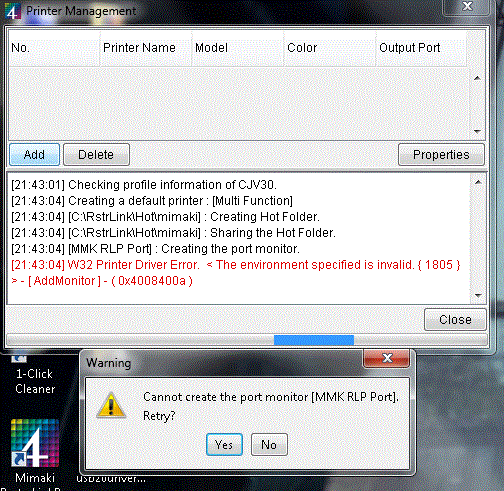

Hello everyone, I try to register my Mimaki CJV30-160 on my new machine dell precision 64bit Windows 7 but in the end I get this error, As same I install on XP without problems.

Hello You must use the latest rasterlink program.
You can download it from the Mimaki website in japan.
I have seen this before.You still use the s/n that came with your original disks
