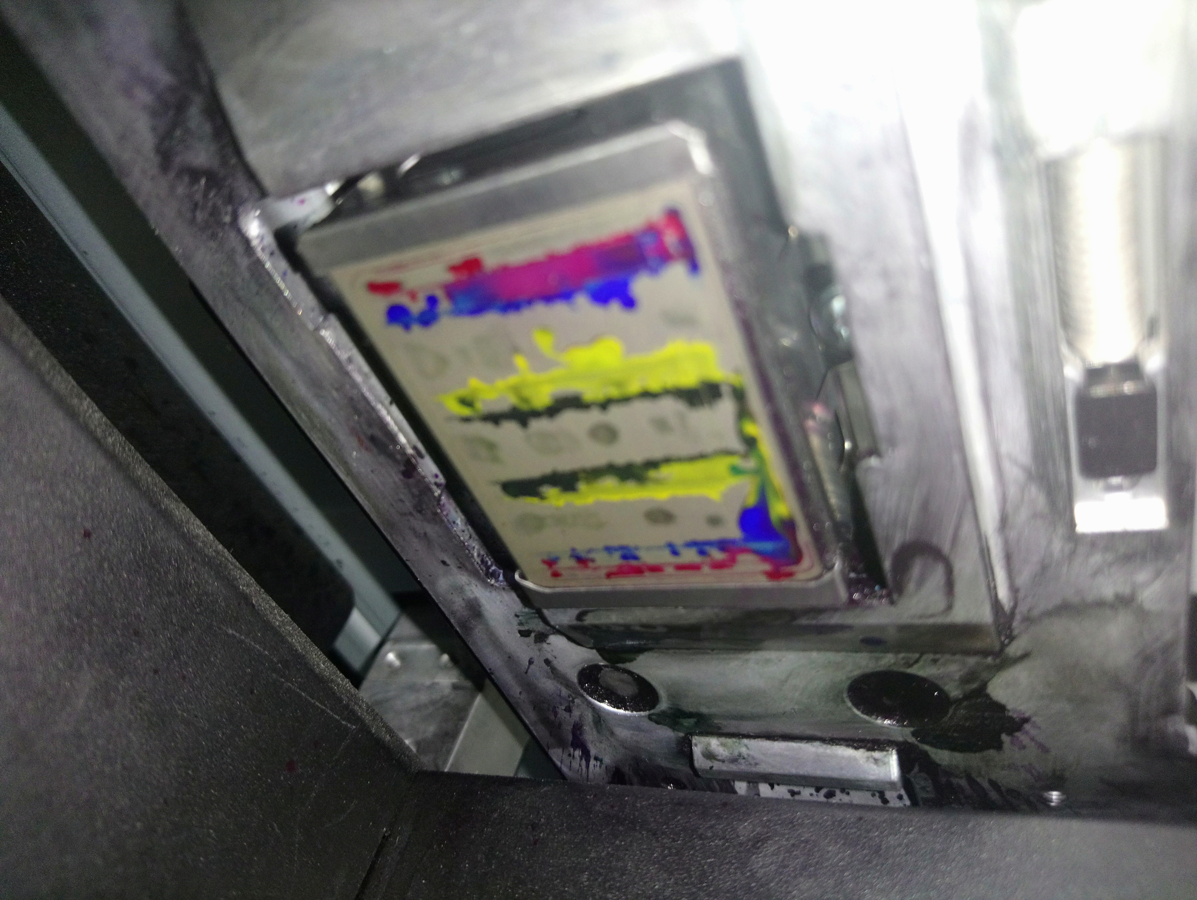

Hi, I have a CJV30-160 and I'm having problems with the head, after printing a few meters the head is full of ink, as shown in the image, someone knows why this happens ?.
The test is correct, new captop.
Thank you.

Dampers could be causing it but also check to make sure your wiper is actually working properly. Looks like it did a cleaning and just didn't wipe the excess ink.
