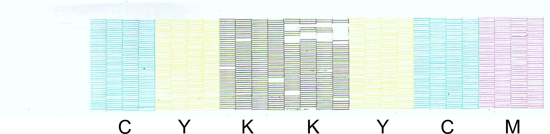

Hoping someone here can help with a problem that the tech is finding hard to get back to me about. My awesome printer is 6 years old-ish and has used maybe 2 cartridges of ink in all those years so it hasn't been used much at all.
Last year it was printing parallelograms instead of rectangles and blurring some of the finer details so I sent some samples to Brisbane and the tech there reckoned the head needed replacing. Fair enough I thought even though it's done bugger all work it's been a long time. After the head was replaced it sat for a while before I used it and nothing printed. Brand new head completely blocked so I did nozzle washes and head cleans until it cleared up a bit but was still nowhere near working. Tech came back, ooops, the pump needed replacing. It has a new capping station and now has a new pump.
The profiles were not good at best but had somehow disappeared, okay, helpful techie installed some new ones and I finally got a print or two out of the machine.
Sits for a coupla months doing it's automatic turning on and flushing itself, as it does. Went to use it and again it needed head cleans and nozzle washes. The other head with the same amount of non-use lasted 5 years without trouble and now I am about to throw the machine ! The test print is nothing like I remember it being and it seems the colours are in the wrong sequence as well.
Also it has gone back to printing parallelograms instead of rectangles which used to mean the encoder is dirty / faulty or the sensor. I turn the machine off at the wall and back on again and sometimes that makes a difference but not every time. ut apparently these issues are related to the head now ?

It looks like the magenta is missing completely on the left side.
Try to do an overnight head soaking (start a maintenance cleaning when the head moves out of the way so you can fill up the capping station with cleaning fluid, then unplug the machine from the wall and push the head back to its location so it touches the liquid) to recover some of the nozzles.
If I were you I'd change the ink tubes and dampers before trying to print as ink particles may have settled down in the tubes earlier, and now that you let it clean itself they may come loose and cause problems. Until then I wouldn't do any hard cleaning.

Yeah it's the missing magenta that bothers me, I've never seen that before.
Thanks for the advice, sounds like a good idea to me. I'll order the dampers and tubes this morning and get the soak happening for the whole day, not like the machine is busy doing anything :)
