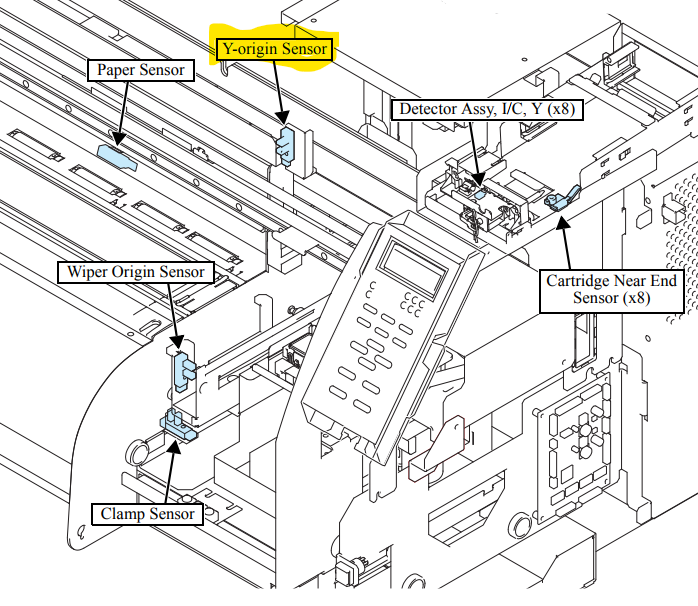

As a "you never know", I unplugged the Y Origin Sensor to see if it threw up a different error - and it did. On plugging it back in it's burst back into life! Hussar!
Will be performing a full flush and clean on Wednesday as it's been waiting for me to fix it for some months, and I dare bet the heads are bunged up!!
So, that's the Y Origin Sensor here:
