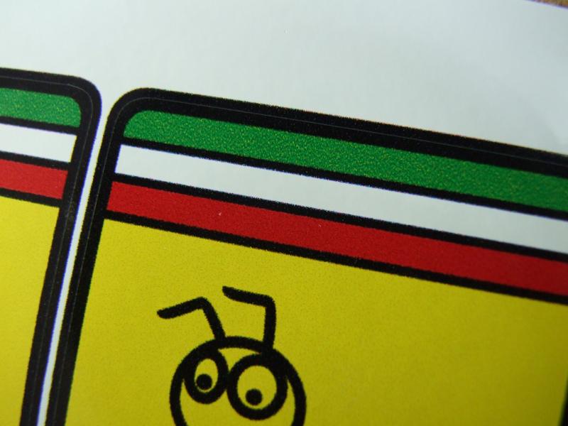

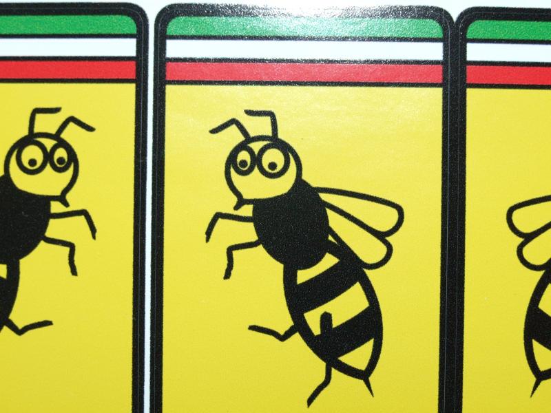

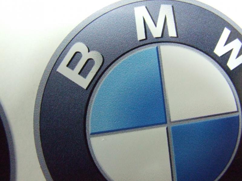

Last week I had new DX5 head on my MIMAKI CJV30 60 . No any adjustments from technician
And this is how prints look :
Test print show no clogged nozzles at all , I am printing on PVC ( LG media LD3910 ) with color profile for ORAJET 3164 , 720 x 1080 , 12 pass , unidirectional , Slow
Raster Link 4 , Eco Solvent Inks ,
Is this something with HEAD SLANT ADJUSTMENT or is it over spray ?
Any help is appreciated
