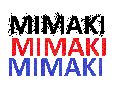

When I print with the mimaki cjv30-160 the black color goes like this:
Does anyone knows what's the problem..

What is your test print look like?
I would think perhaps head dirty try a nozzle wash for at least 30 mins.
I would like to see what the test print looks like. But to me it is nozzle deflection/overspray. Are you using OE inks or aftermarket?
Worst case new head ..but lets see first..
Tekkie1:thumb:
Masseria
misfiring/overspray. if i were you i would send cleaning solution through the printhead manually, taking out the dampers. and then doing a nozzle wash for at least 10 minutes.
