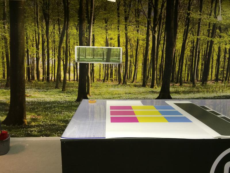

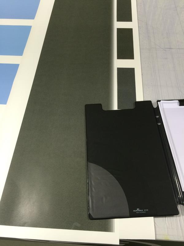

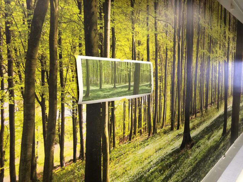

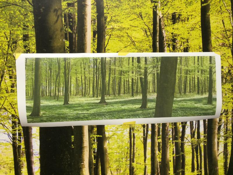

I have a big problem with my Mimaki cjv30-130. I had two weeks of vacation, so the printer:) but now when I'm printing , images are very bright, especially black is gray / green.
I post some pictures. I have hung up a thumbnail of the photo wallpaper, you will see the difference. I have used the same settings as before and the same paper.
Should I be worried? Does anyone recognize this? Hope there is some good friends on the other side of the planet who can help me. :)
Thank you
// Rikard Linkfeldt (Skyltpartner in Gothernburg)

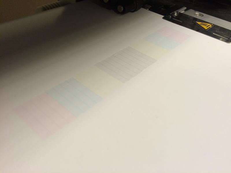

What does your nozzle test print look like?
If the machine sat without printing for a lengthy period of time (say more than 4-7 days, it is very likely that you have a number of nozzle outs (clogged nozzles). I would suspect the Black with possibly Magenta or other colors being affected as well. Inactivity is usually a major problem with almost all solvent and eco-solvent printers.
Please print, and post an image of the Nozzle Test and this would help others tell you how to best proceed to try to get them recovered.

I think it looks alright. There are 3 excluded nozzles that I have to deal with later. Could it have something to do with the software?
thank you!
