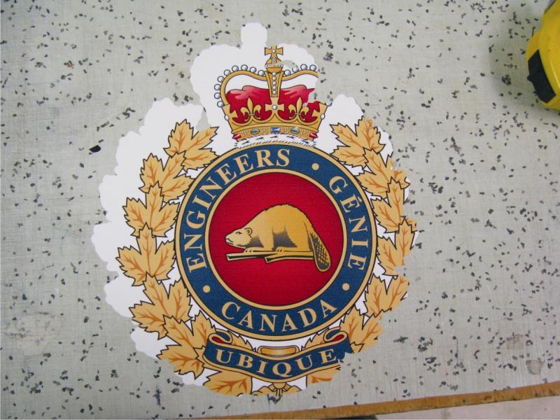

Hey all we just bought a new CJV30-130 2 weeks ago and everything was going well until it this cutting problem started where it is consistently off .5" off on top and bottom..the thing is it read the crop marks perfectly every time it just doesn't cut right..also I have not changed anything on the machine settings or in rasterlink any kind of feed back here would be a big help...

Looks similar to what was happening on my summa. In my case it was a calibration issue. The knife head position in relation to the opus eye wasn't set-correctly. Although mine was only out about 1/16th of an inch.
ciggyboy
Just to let everyone know I spent the better half of the day with Mimaki USA tech support and we were able to resolve the problem...seems CorelX4 is not totally 100% compatible with Rasterlink yet...and as soon as I switched back to Corel12 issue was solved!!!
