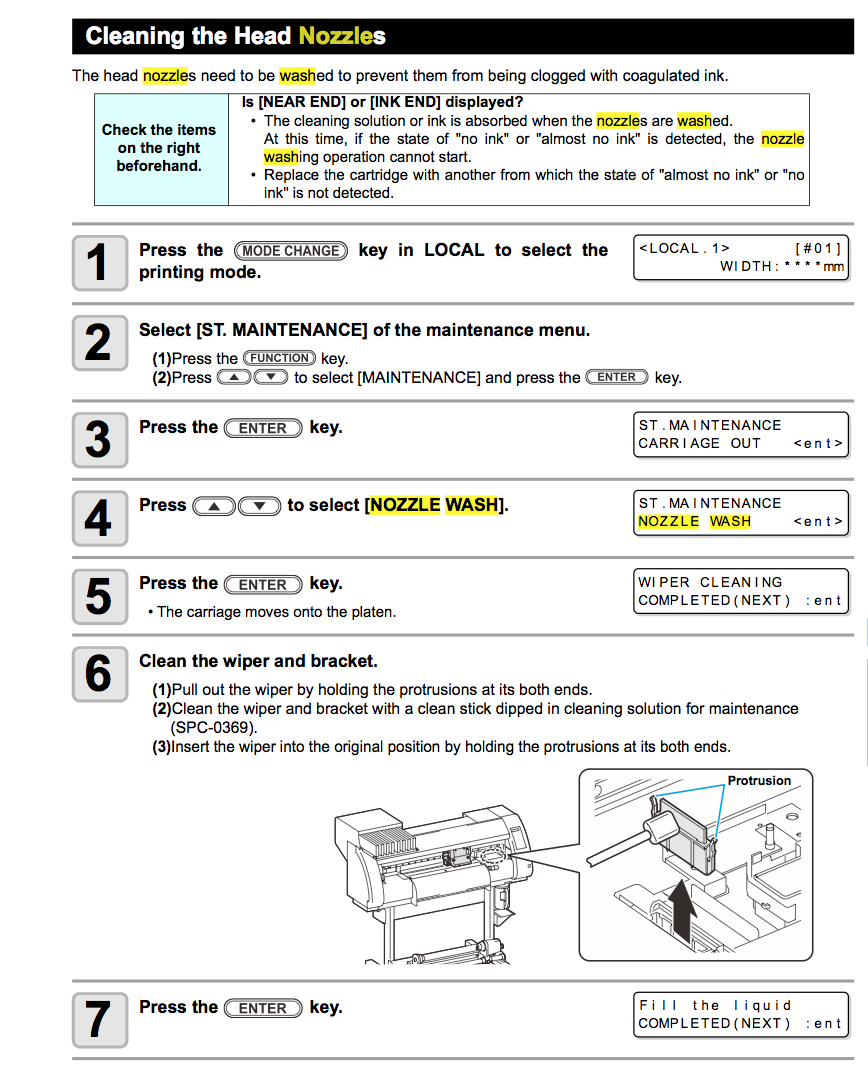

Do a nozzle Wash.. I can give you info on how to do it so the head soaks and it might clean things up for you.

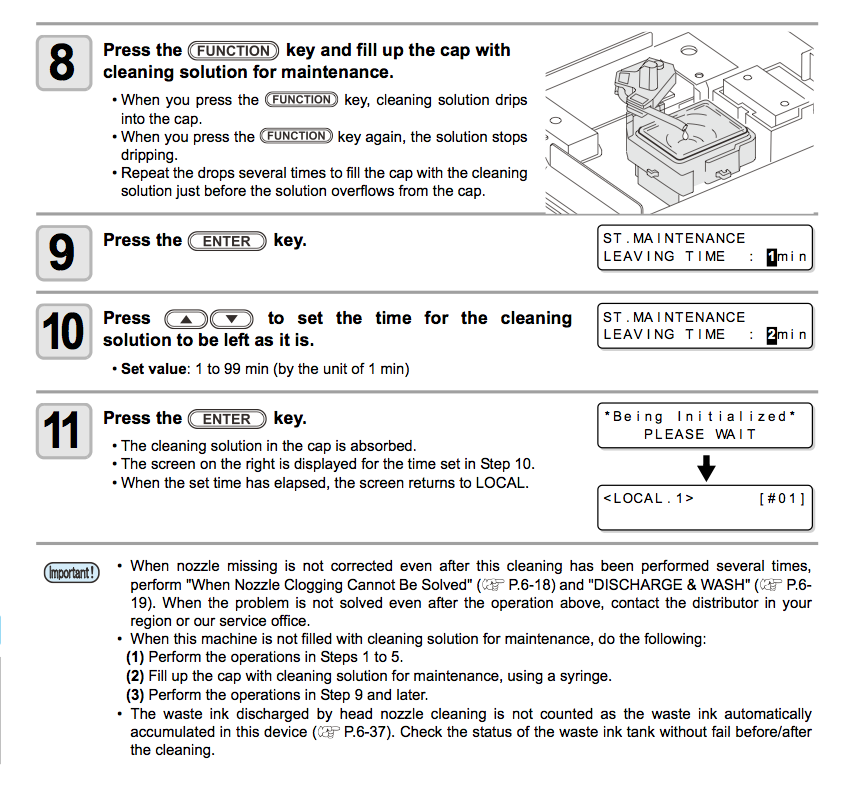

Do these steps. Set the time for 10 minutes and unplug the printer from the wall and let it sit overnight. Plug it back into power in the morning and turn on and do a Cleaning. Then do a test.... If you see improvements you can do this again.
When doing step 8 Fill the cap FULL, it will automatically shut off when filling so you have to push function again to get more fluid in the cap.
