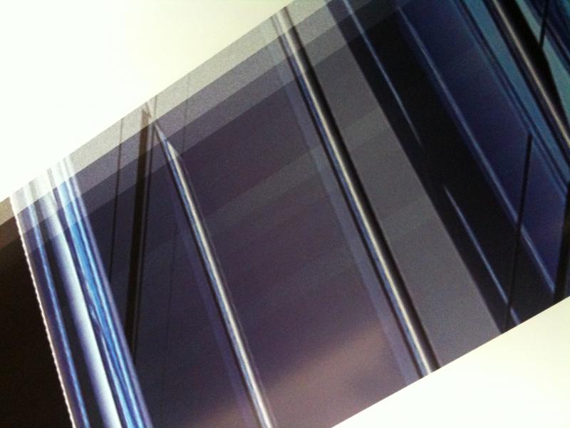

So I had my CJV30 for about a year now and its been fine but recently its not been printing right, I am getting some passes that are light and some are normal, seems to be random and I cant get rid of it, any ideas? I included a pic to show what Im talking about.

it's data, but i'd first print some big blocks of c, m, y, and k to see if you can isolate it to a channel on the print head.
Brandex.ca
So I printed a 12" block of each pure color and has the same thing through all colors, can't really notice it in black and yellow though, what next?

The encoder strip is the clear 1" strip that runs along the width of the printer behind your print head but up above it and the sensor is behind your slider board above your heads, you have to take your black cover off first to get to it

Ok so the funky line issue was fixed by cleaning the encoder strip and sensor and the ink dropout during my long print seems to have been caused by a bad pack sensor that did not allow it to switch packs when empty, in return the dampers did not fill fast enough.
Brandex.ca
Ok so I take it back, I am still getting this light line issue just not as bad and not all the time, and it's totally random on where it shows up, time to buy Roland?
