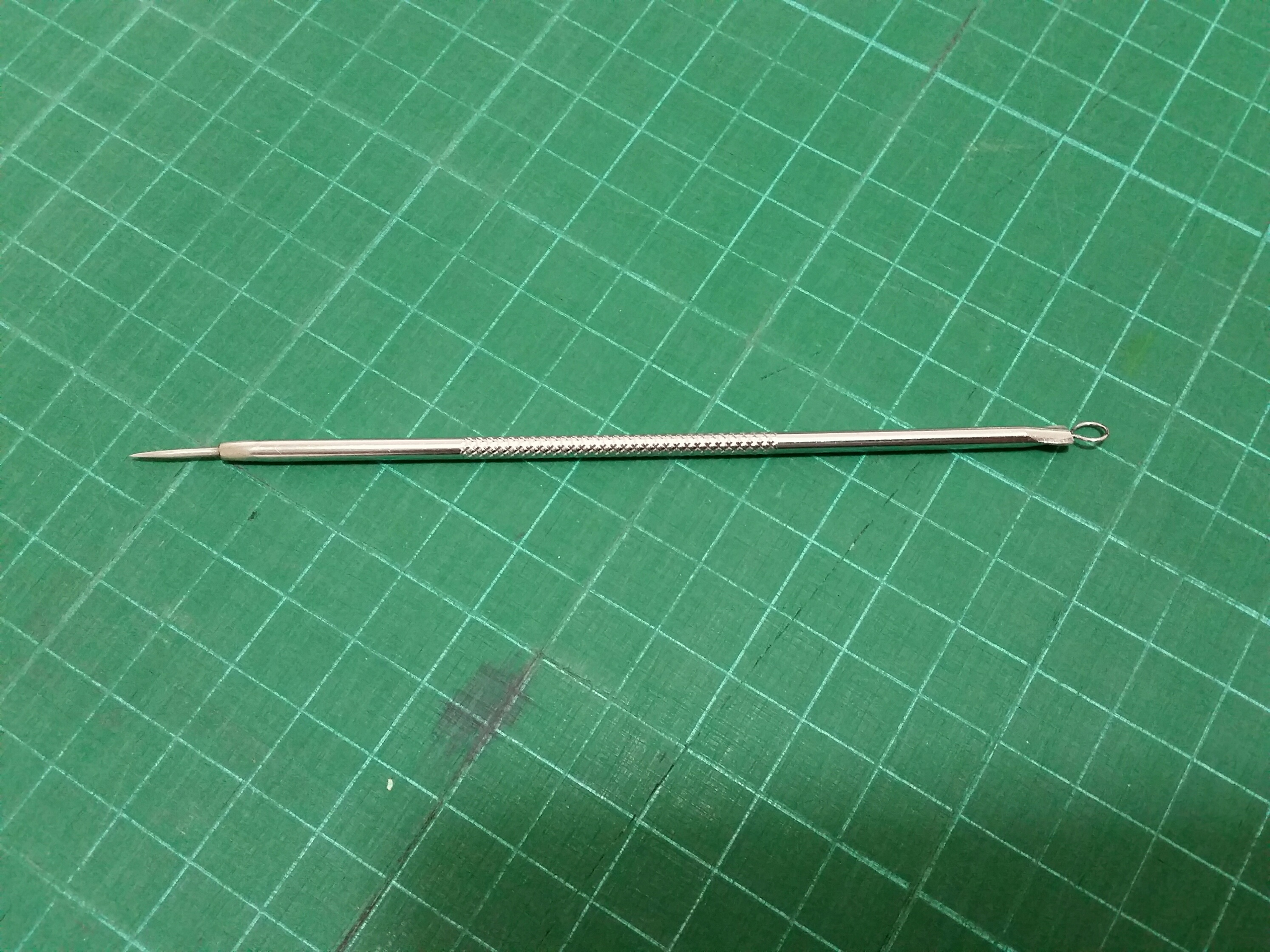

Having had a lot of time on my hands one afternoon, I used a small paint brush to brush out the dust in one hand with a vaccuum (low suction) in the other hand, flicking the dust up. The glue residue on the rollers were removed slowly using a cloth with iso alcohol small sections at a time and a very fine pointy metal object, slowly turning each roller untill all rollers where clean and glue free. (Can't believe how new they all looked!). The iso loosened the glue a little and I scraped the rest out with this object, while wiping at the same time with the cloth.
Yes, this took much time but I love my Summa D160!
Here's a pic of the tool I use, it doubles up as my weeding tool also.
