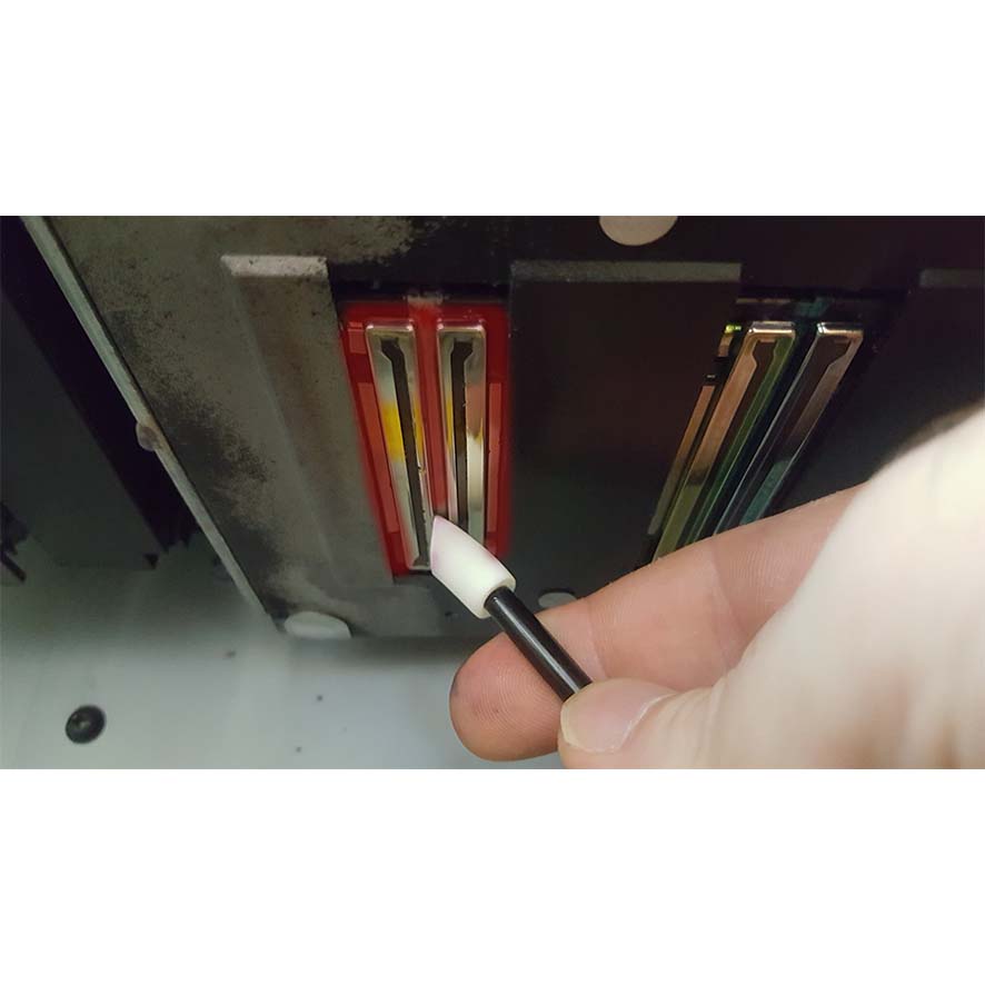

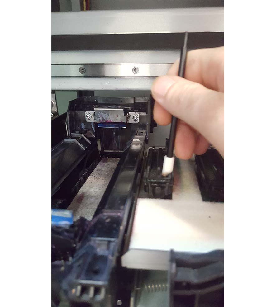

Hello , i am working on ujf60-42 mkII . Had same problem with clear and primer . Did you try different resolutions ( on ujf 600x600 or for base clear printing, different % of amount of clear ) Materials want to deform under UV lamp too (then mist is problem ). Did you check dishway wash , nozzle wash? nozzle.jpg nozzle2.jpg
