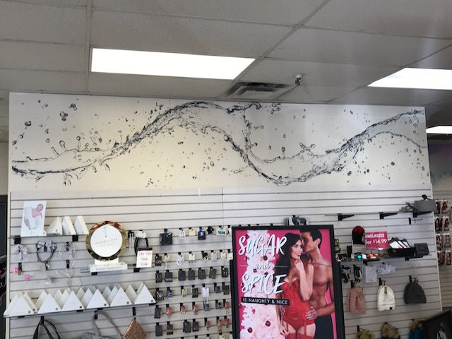

Here is a printable clear we did on a wall. Worked really well but takes extra time as any air channel and imperfection is plainly visible.
In my case, it's just cut vinyl. But I always wondering how it would look and install on drywall for printed film. Do you mind sharing what material you used and the technique? Did you premask it?
