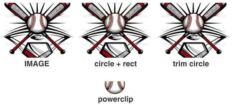

I hope this explains it:
LUV DEM TIGERS
Thanks so much. And thanks about the uncheck powerclip center thing. I have had troubles with powerclipping, and that was my problem.
