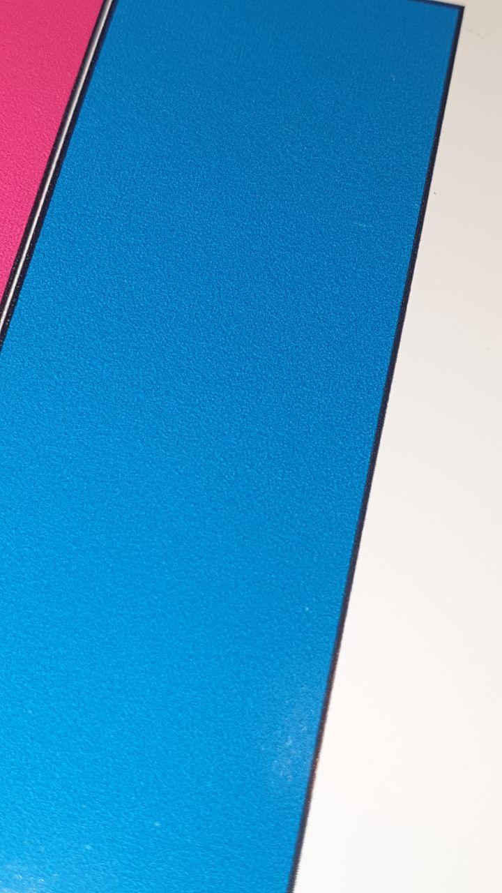

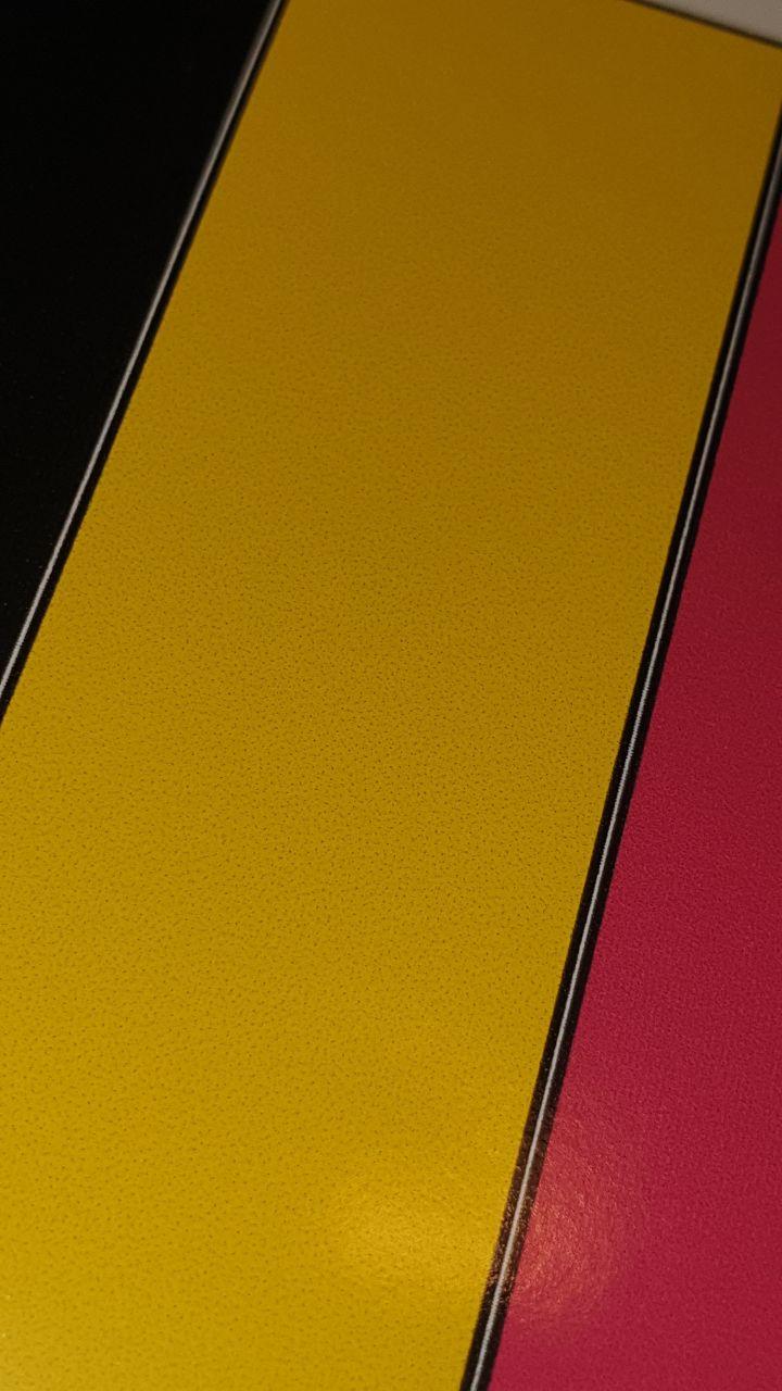

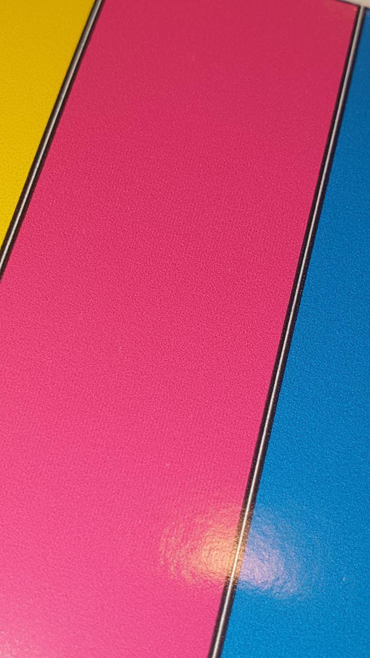

I printed a CMYK test (100% of each color) on S21 CMYK inkts
my output looks like this, the yellow band the dithers are the best visible,
file was a AI file in CMYK document setup
also checked with color replacement in rasterlink and indicated 100% for each color but visible it isn't 100% yellow only
fyi the dither isn't black (so no overspray from the lines that border the band)
any ideas ?

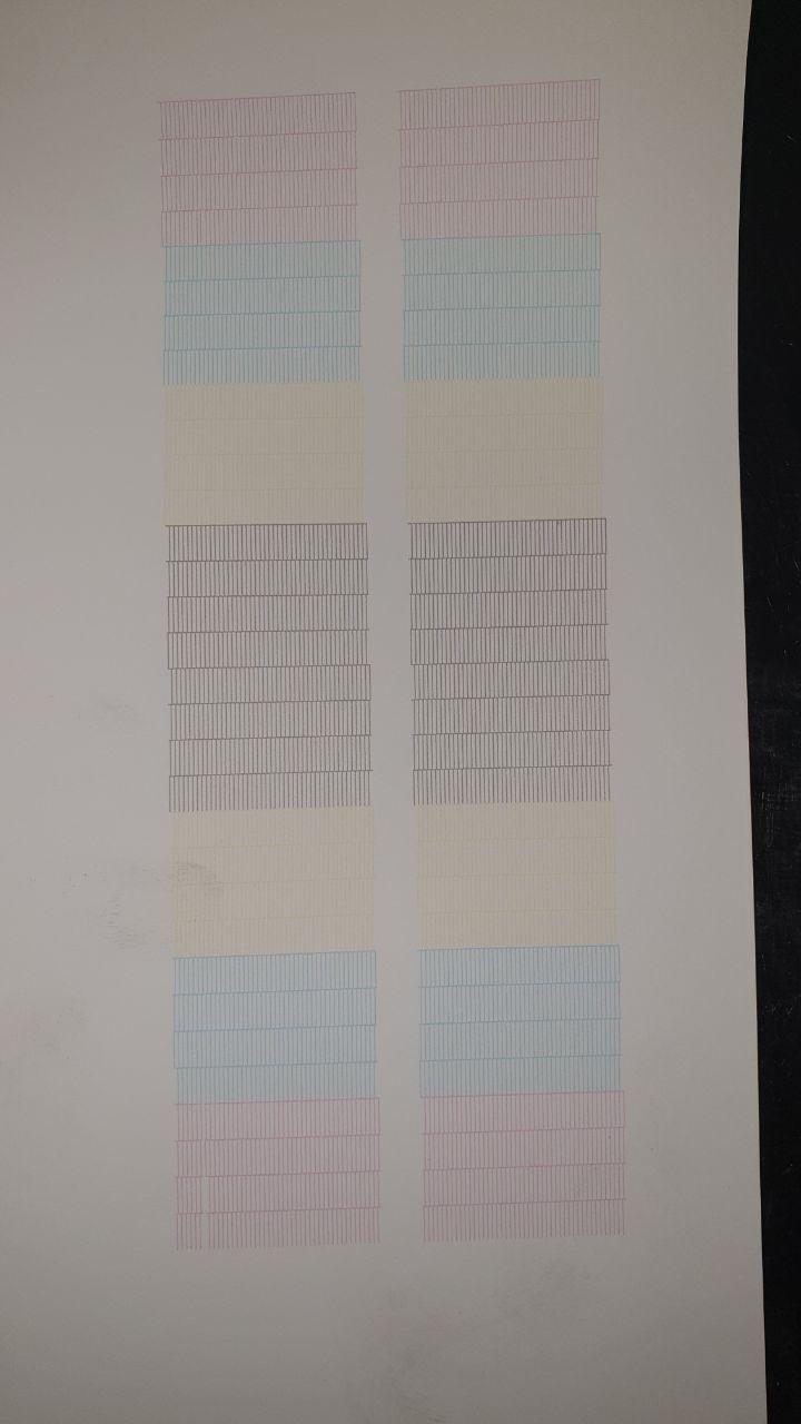

can I see a test print of the nozzles?
Looks like heat issue.
any ideas ?
turn colour managing/icc off in your RIP if you want pure CMYK.
as requested ..
heat issue? i used the media profile of siser soft print, i got the media as well here, tested, but same problem
